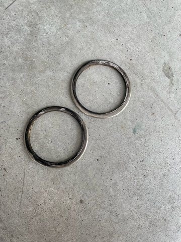

Originally Posted by is500le
My dealer knew about the issue because I told them. They checked it out and reset the torque setting. I haven't had the issue popup so that may be all is needed. Of course this is all conjecture as I could get it tomorrow or never.
In theory this may work if the car is still brand new and the gaskets didn’t fully cook in yet…
The OEM crush gaskets are intended to be one time use.. Soo if they are over torqued they will be crushed further creating a leak since they will not seal or seat well during heat cycles of expansion / contraction.
Formally Lexus has not issued the LSB, the new IS 500 owners have been waiting for..
Once they start leaking, a new pair are HIGHLY RECOMMENDED to solve the leak & CEL for P013A
2 of the 90917-06070 GASKETS used & leaking.
Exhibit A - areas where the leak occur
