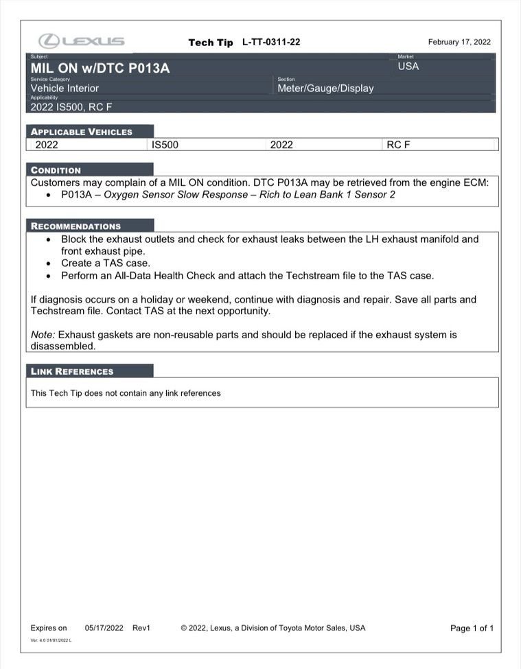

@wthrman2
L-TT-0311-22
You’re Welcome

Looks like Lexus is probably on the way to a bulletin for this issue.
The only problem with Tech Tips is that they are regional and not official bulletins.
So a US Tech Tip would likely never become a Canadian Tech Tip cause it's not the official fix.
The reality is the issue would potentially effect all IS500's cause they are all built in the same place, using the same supply of gaskets.
The Tech Tip is more of a "this will likely fix your issue" type document.
I take your point, but every little bit helps. Initially, Lexus did not directly address the issue. When the tech tip was published, it put points on the board for us. Luckily (at 1800 miles) I have not experienced the issue, but you never know and the more info out there, the better.

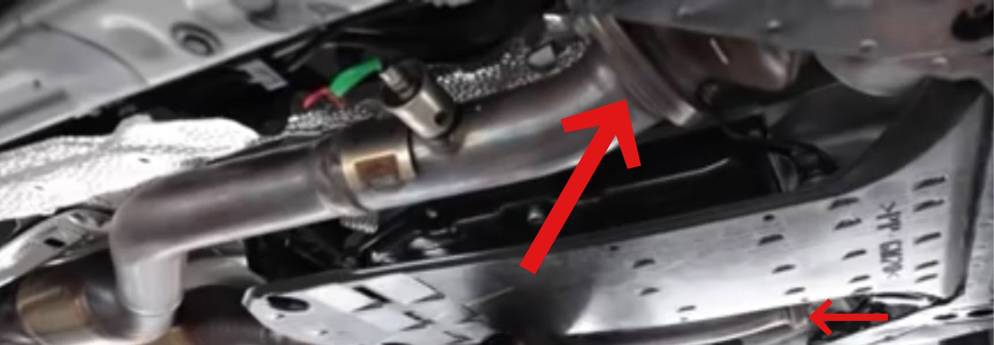

I’m leaning towards a potential manufacturing defect on either the manifold or mid pipe exhaust flange…
Basically how they are welded in angle wise… Even a few MM’s off will create a problem.
These flanges need to perfectly align as well as the gasket needs to make the correct seal onto the seated flanges..
A new exhaust gasket may be temporarily solving the leak issue and after X amount of heat cycles the gasket will lose its effectiveness…
And then failure re occurs..!!
Below is an actual IS 500 and area of concern.. Except we would be talking about the drivers LH side..

Tech Tip L-TT-0311-22
L-TT-0311-22
Joe Z
