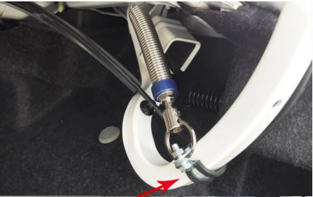

Or this things:
https://www.aliexpress.com/item/1005...martRedirect=y
