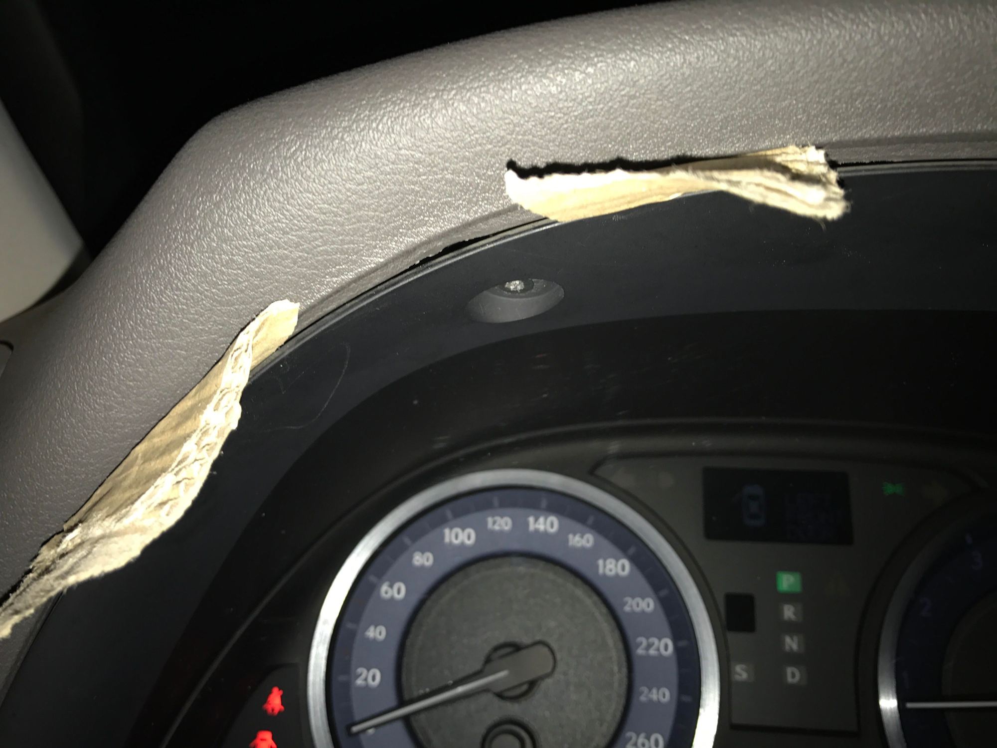

This currently how I solve the rattle, any suggestions?

Get an Eraser that's like a rectangular box, and then taper the long edge and shove it into the gap where the windshield meets the front of the dash.
This is what I did and it helps BIG time. The tapering is kind of tough actually, but it helps squeeze the eraser in there. I actually don't have mine tapered and it still works well, I just haven't gotten around to it...
The TSIB is only for cars under basic warranty. Your car is probably out of the 4 years.
If putting paper there solves it, then that's where the rattle is coming from. It's a common place to rattle for a lot of IS -- some of the is on the bottom of the cluster. A less ghetto way to do this is go buy some black felt tape from Michaels and try to wedge it in there.

I tried to solve mine by putting black electrical tape in the same places that you did on your photo but I don't think I put enough so it started rattling again. I probably should try black felt tape like Nosurprise said but I never tried fixing it again since I got used to it.

I solved mine by putting 1/8 thk foam. I pulled the whole instrument cluster out. Once you do this you can see clearly how the the cluster, and the dash holder behind is also plastic. Some places I had to double up the foam to make it thicker. There is no support for the cluster itself that's why you get rattling. For the two screws. I cut small squares and placed them in between the dash and the cluster. You'll have to push through the screw clip first. Then just retighten the 2 screws back.
