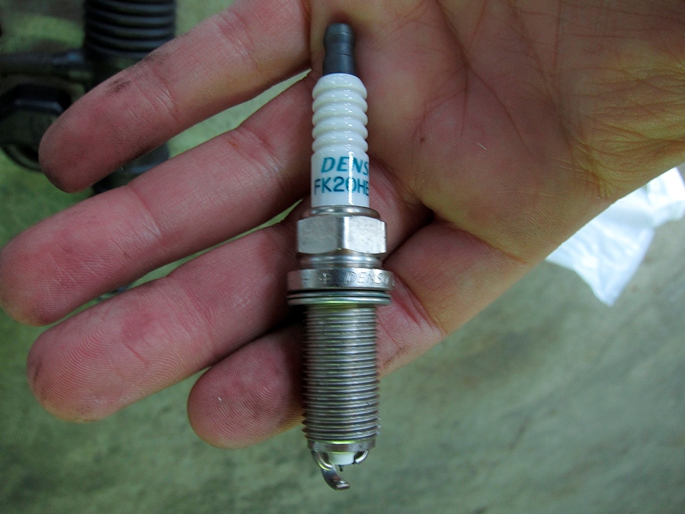

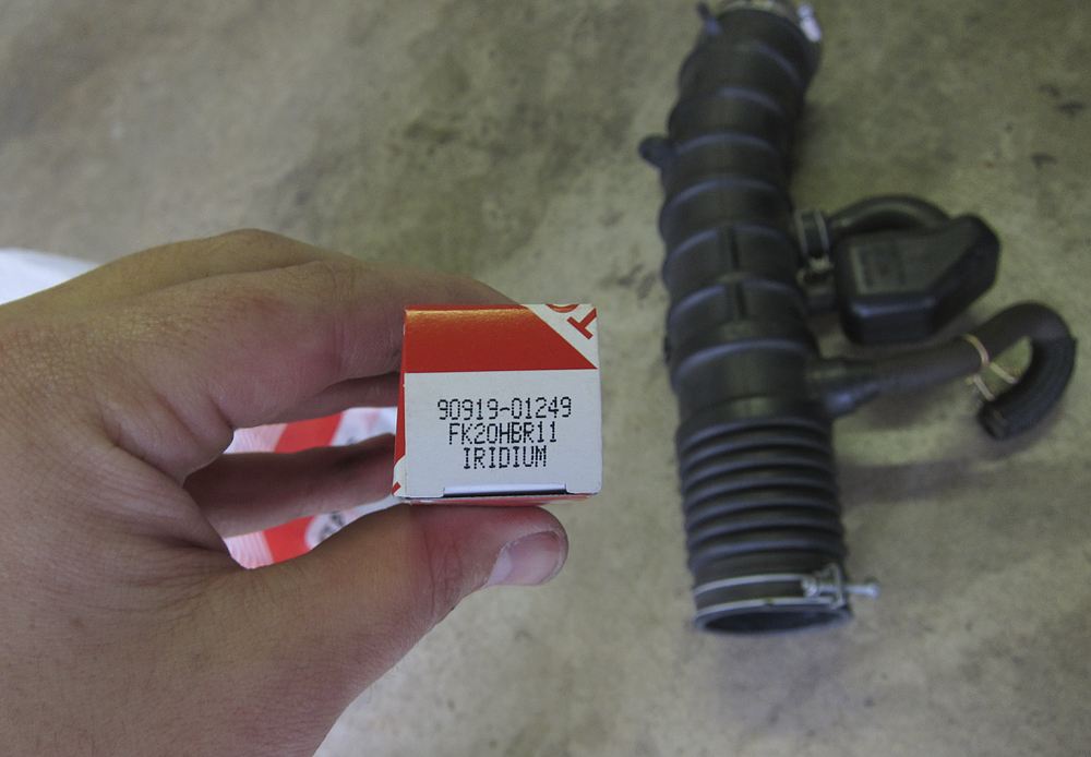

You'll need 6 spark plugs - I used the OEM Denso plugs, Lexus part # 90919-01249:
These plugs come pre-gapped, so if you're using the OEM Denso Iridium plugs DO NOT adjust the gap on these plugs.

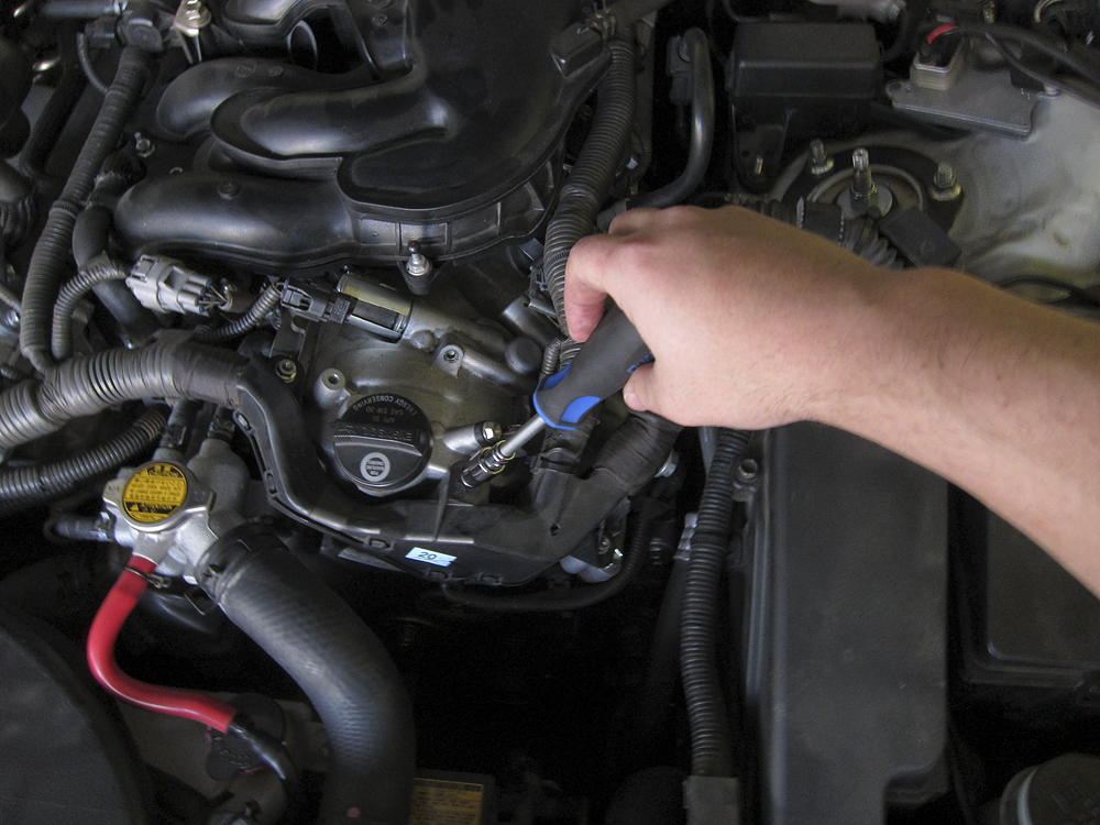

I started with the passenger side. There are a few 10mm nuts that are fastening a harness over the ignition tubes, partially blocking access. Remove them:
Next loosen the 10mm bolts fastening the tubes to the engine block.

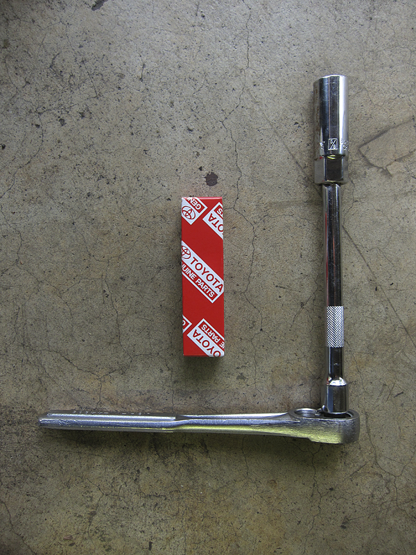

Now you'll need your spark plug socket with the 6" extender bar. The spark plug socket is a special deep socket that has rubber grommets inside that will grab the spark plug and let you remove it from inside the ignition shaft:
This is what the whole thing looks like:
You're going to need every bit of that extender bar to remove the plugs:

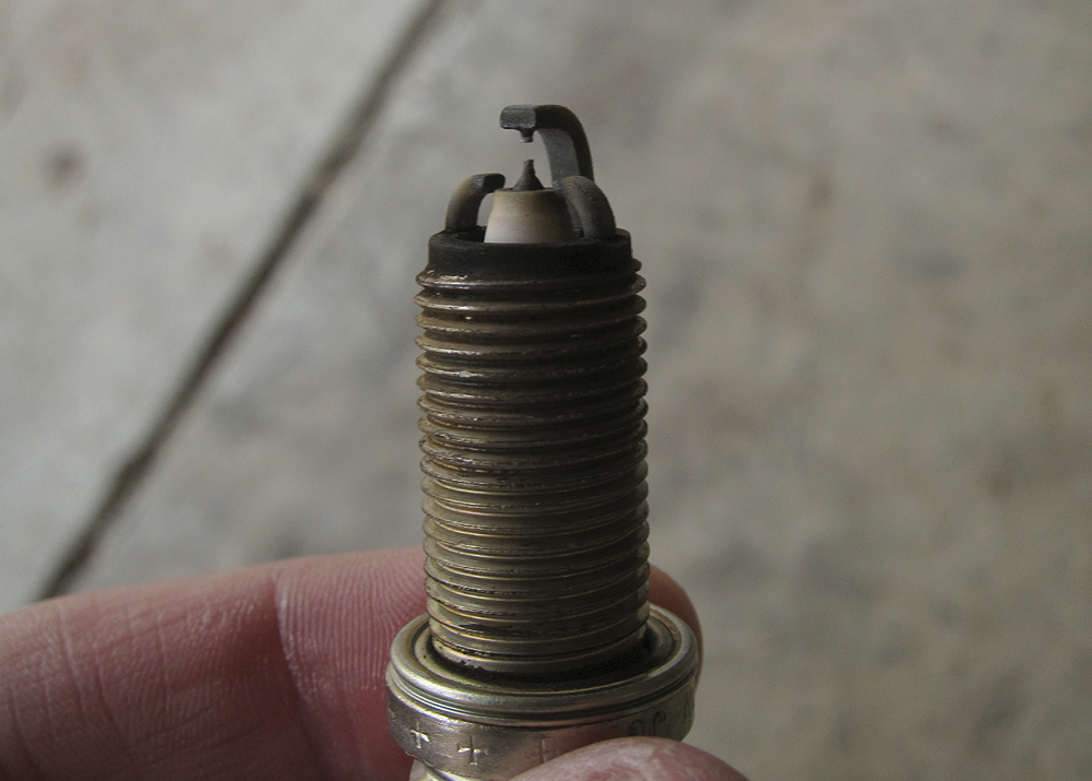

This was the first plug I removed (at 60,000 miles)

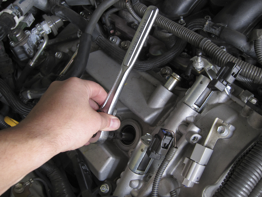

Now on to the driver's side. This side will be a little more difficult as there are a few wiring harnesses that must be removed in order to gain access to the bolts that secure the ignition tubes. Start by removing these two nuts:
You can then lift the harness out of the way just enough to slip a box wrench (the ratcheting type will make your life a whole lot easier) behind and unfasten the ignition coil tube:
Remove or loosen any wiring harnesses that impede your access to the ignition coil tube bolts. The final bolt can be accessed from above with a little elbow grease:
