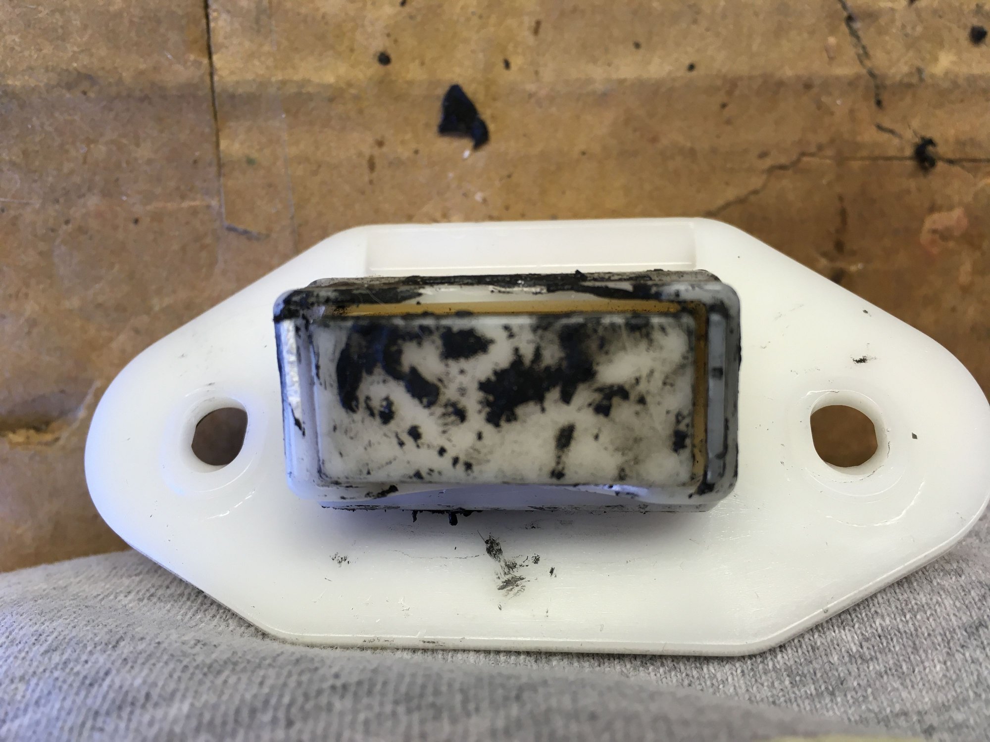

I tackled this job yesterday afternoon after reading this thread. I didn't want to spend $50 on the part, so I removed the switch, cleaned off the gooey black rubber which had "melted" and was jamming it, replaced the rubber with a piece of bicycle inner tube, and put it all back together. It works like new!
A couple of notes for anyone interested in trying this:

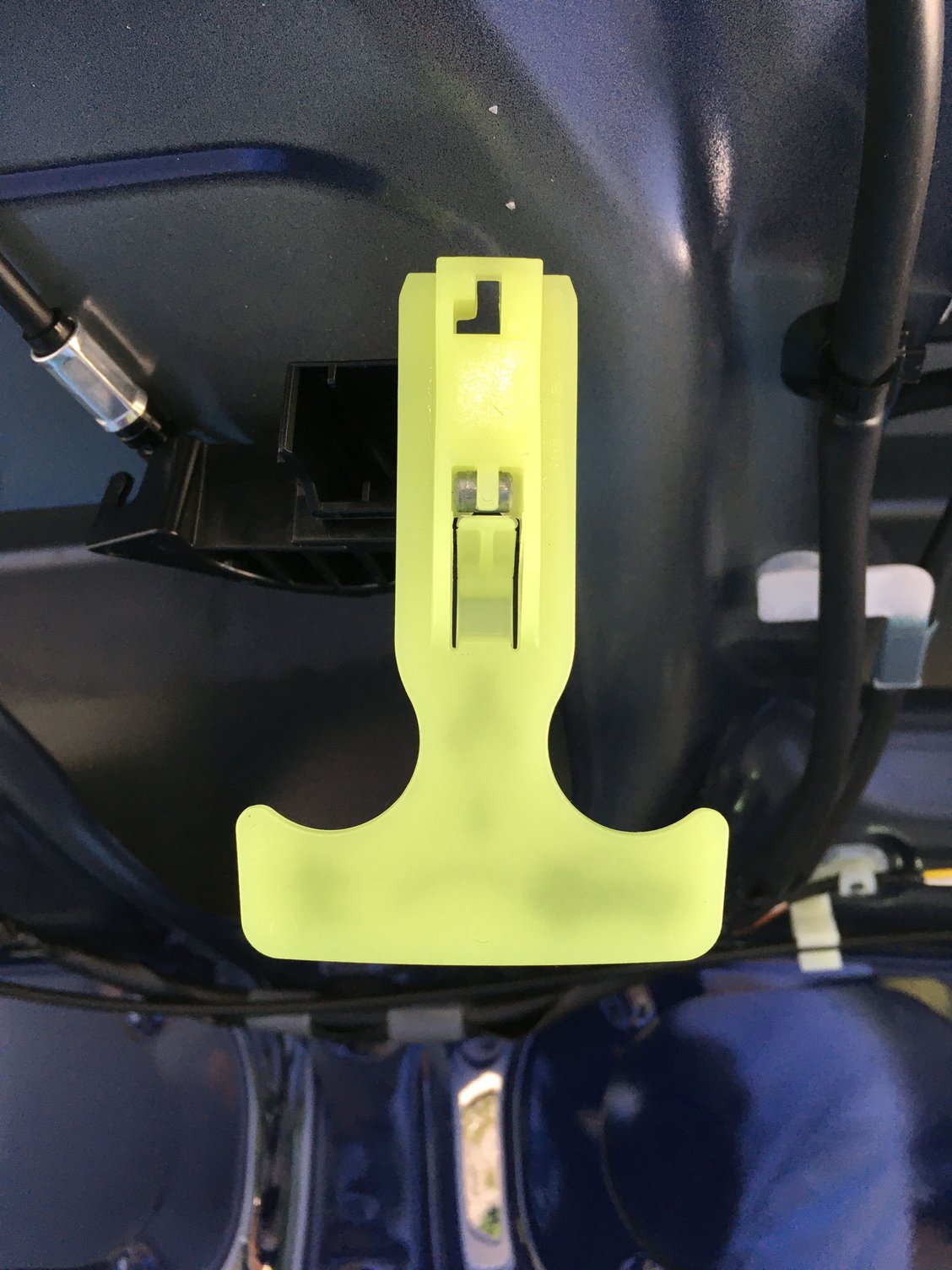

The job is moderately difficult for a couple of reasons. The in-trunk manual release is tricky to remove, and it needs to be removed to get the trunk lid's liner off. The base of the T-handle is two-part, and the two pieces need to be snapped apart before one can remove the handle, base and liner. Sorry I don't have a picture of the two-part base.
The only other difficult part is removing all the gooey rubber from the moving parts of the switch. I used a metal pick like the one the dental hygienist uses to scrap plaque from teeth.

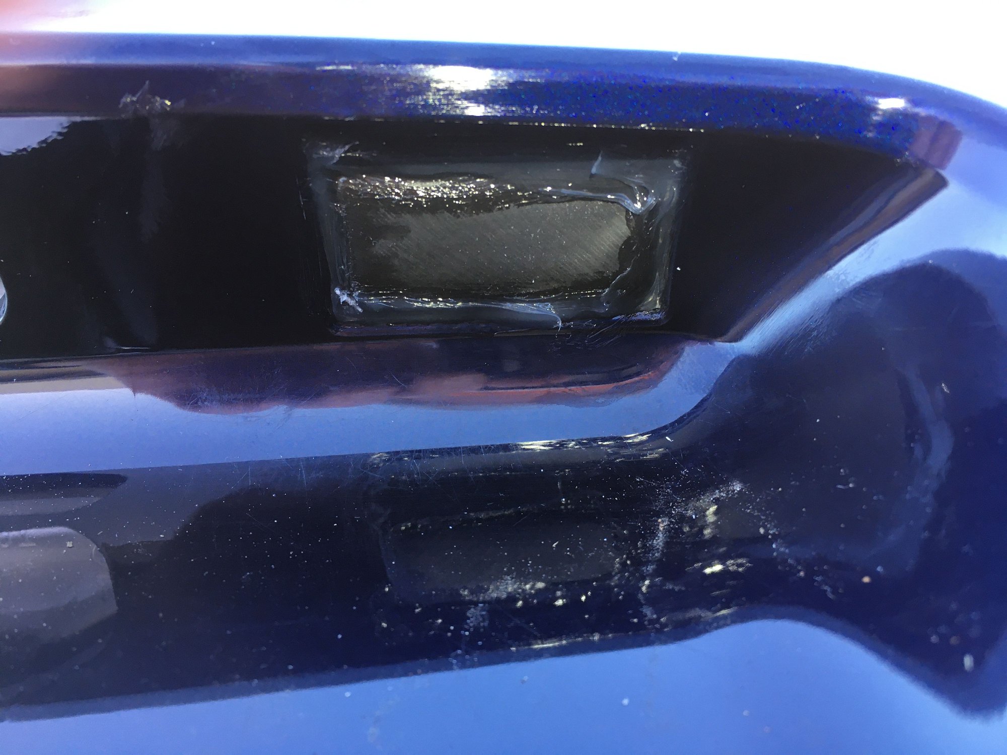

It was relatively easy to trim the piece of inner tube to size, and I held it in place with a rubber band. After bolting the switch back in place, it seemed to have a really good seal from the exterior, but in the end, I decided to add the silicone for insurance. Black silicone would have been preferable, but I used the clear because I had it "in stock." BTW...nobody ever sees this switch.

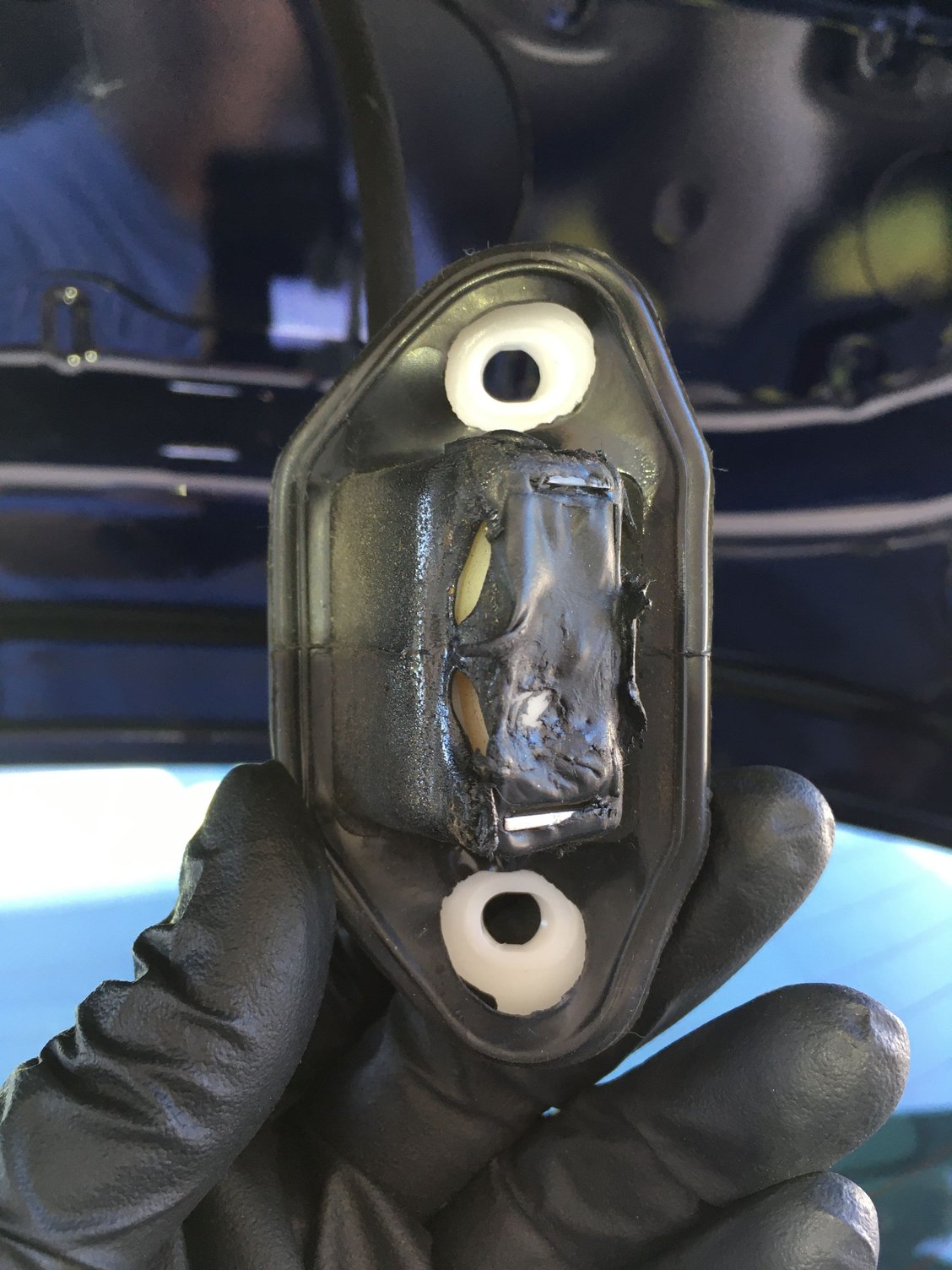

I tried to clean the gunk from the outgoing part and it turned into a frustrating exercise pretty quickly!
I was using a degreaser, box cutter and a flathead screwdriver.
I ended up tossing it since I couldn’t get it as clean as I wanted it and the action of the switch was still sticking when pressed.
