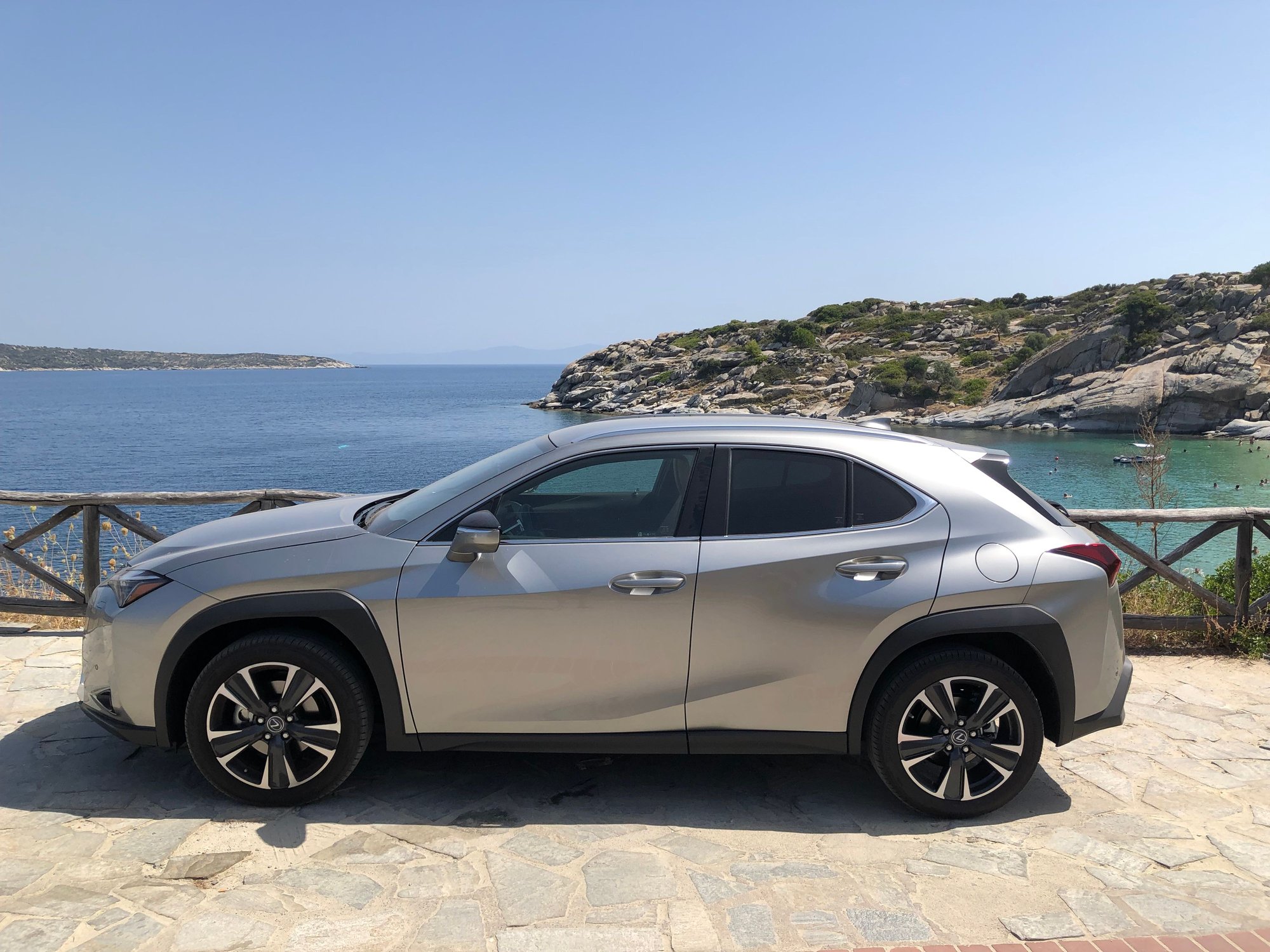

I am sure that it will be fixed! When I first discussed the problem with the notification and navigation with my dealer they asked me if the sos led light remained red. After that, they said it could be a problem with a module, where sos button is placed. I don’t unfortunately understand it but they fixed it and since August the sos light remains green.
I love my UX and I also love Greece! My favourite country! This last summer visited many places and awesome beaches in Kassandra and Sithonia Peninsula, also Thessaloniki for couple of days, love it 😊
