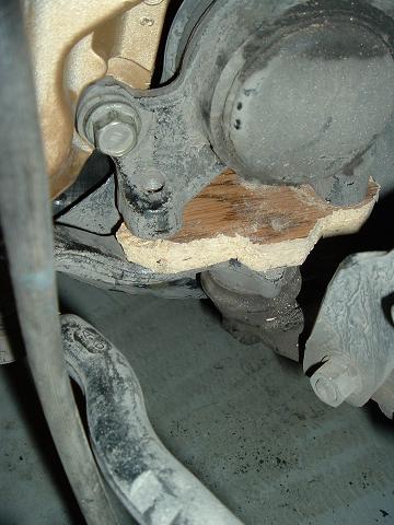

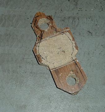

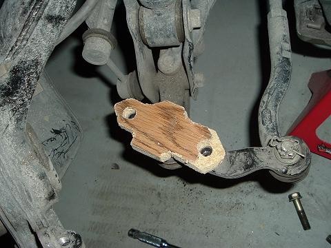

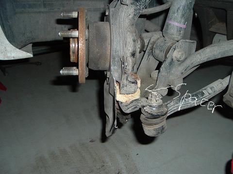

here are some pictures of what the spacer look like and where does it go.
I made the protype with wood, so that I can take the measurements.
If you have any questions, feel free to ask.
No, this spacer will not fix your camber.... unless you have adjustable coil overs and Yes, it will lower your car however thick the spacer is. In the picture, I used a 1/4 inch thick wood, but the aluminum one that I made for my car is 1/2 inch thick.
Good Luck everyone
Good Luck everyone
The roll center adapter will straighten out camber because I have it on my car and the before and after camber adjustment is all the proof I need ..Because by installing this you actaully raise the steering knuckle instead of bringing the car down to lower it..this adapter is better suited for those who have coilovers because the front will be lower than the rear...
