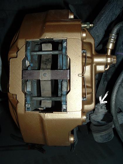

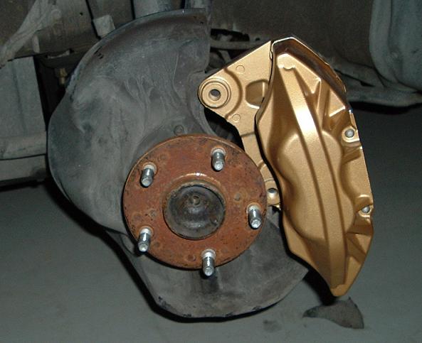

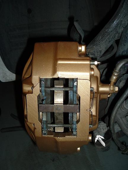

I'm sure many of you guys out there have seen IS and SC install LS400 brakes and also Supra TT brakes. Well, just for the record, the LS brakes DO NOT fit 2rd Gen GS!!!!
The following pictures will show what didn't fit.
btw, now they're up for sale. If you're looking for this setup for your SC or IS, PM me. I have the calipers and Rotora slotted & drilled rotors.
After looking at it for about 30 mins or so, I found a way to fit them. Very simply to do, no cutting or grinding required.
Attached Thumbnails LS400 brakes do fit 2nd Gen GS!!-1.jpg   LS400 brakes do fit 2nd Gen GS!!-2.jpg   LS400 brakes do fit 2nd Gen GS!!-3.jpg   LS400 brakes do fit 2nd Gen GS!!-4.jpg

well.... I took the pictures of where it didn't fit. it was totally pressing against the knockle. From what I remembered, I checked and double check that I had the Left caliper on the Driver side.....
Darn it!!! THIS SUCKS!!!!! What am I doing wrong???

Yeah,
I had to perform some "magic" to make them fit on Jawnthens car.
I trimmed both the steering knuckle bolt and just a little of the caliper.
Not technically a good thing to do, but Jawnthen was "committed" to make them fit.
We installed the calipers umpteen times and I just kept shaving the corner of the bolt until it cleared. I used a dremel, with kevlar blades and a very steady hand .
One word of caution, don't cut into the caliper body too much since you can cut through to the brake fluid reservoir !
Johnee78, if you have another way to do it, please share with us.
One more note. The LS rotors are NOT the same diameter as the TT rotors. LS are slightly smaller.

ok so it's not direct fit then. in that case i wouldn't call the ls400 brakes a bolt on at all. far from it actually. personally i wouldn't feel safe doing that to get the brakes to fit
Old Dec 21, 2004 | 06:13 PM
RMMGS4's Avatar
RMMGS4
Northern California Regional Officer
Joined: May 2001
Posts: 8,702
Well one way to get the calipers to fit is to rotate the caliper slightly towards the 12 o'clock position so it doesn't hit the steering linkage.
This would require a custom bracket and probably what jtanoyo1's set up does.
There's another way, but I'm not telling either !
