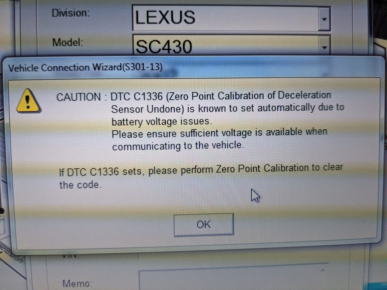

Originally Posted by docjenn
After checking 05 with techstream VSC, VSC OFF lights came on. What is the best way to turn them off?
Since you already have Techstream, you can just go back in and do a Zero Point Calibration to remove the VSC & VSC OFF lights. No need to jump the pin #4 & #14.
Once the VSC & VSC OFF lights came on, this is the message when you open Techstream.
