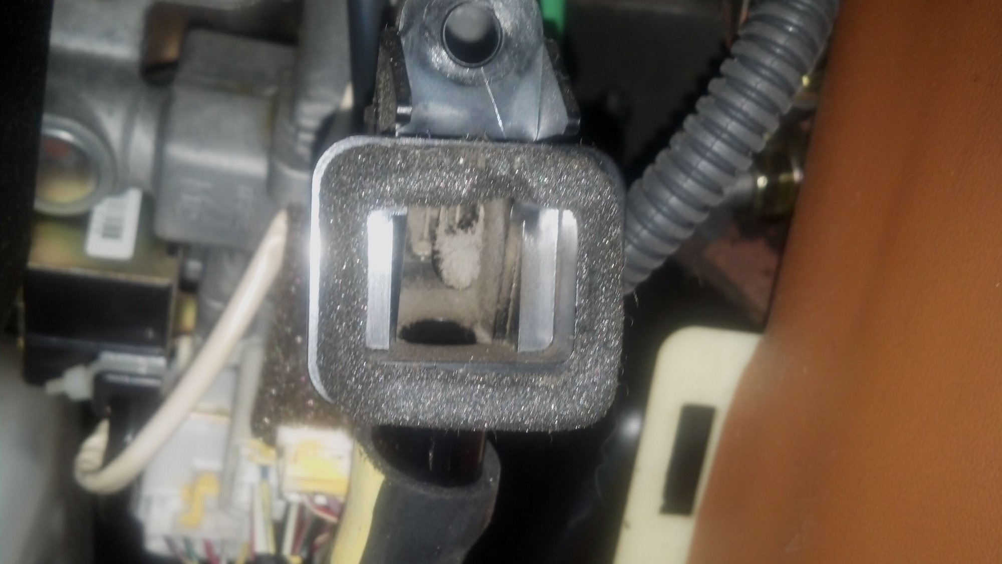

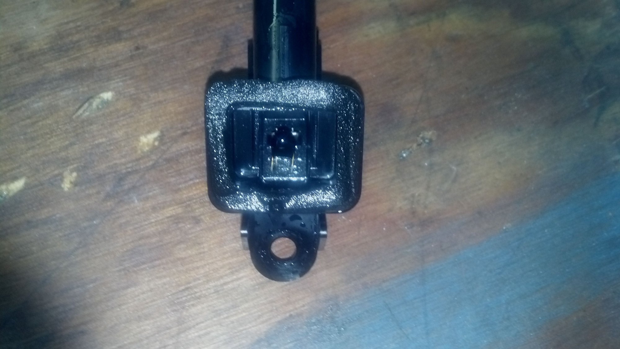

You are amazing Daryl, it could be his problem, I cleaned mine once in the 2002 because it was nasty. Makes me wonder if they disconnected it or it could be dirty. See before and after pics, plus location below.
it’s on the lower dash in front of your right knee…the Third pic is from a ebay pic…not my car.
this was the 2002-2005 configuration.
The tube connects to the HVAC air box and the fan pulls cabin air over the sensor.
if the installers removed this panel, they might of disconnected the plug or when they removed the old radio, they disconnected this plug by mistake.
not saying this is the problem but something to check.
I used a sensor cleaner
