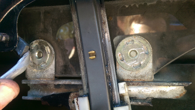

How on earth can you take these off?! Took a 14mm wrench and also a 14mm universal socket and it just won't grab all the way. The wrench sometimes grabbed... What's the trick to getting this damn thing off so I can pull the window out and begin fixing the regulator!!!
Attachment 378845
I used long nose pliers that could handle the twist required. You have to be careful and use a firm twist motion. No doubt there is a tool designed to remove them but I didn't look for one.
You put the point of the pliers in the "holes" directly opposite each other and using two hands on the pliers twist to undo them.

Had no luck trying to do this, perhaps the grip of the needle nose I was using might of contributed to that...
Is there any way to remove the regulator WITHOUT removing the glass? I contemplated shattering it just to make this job easier...
