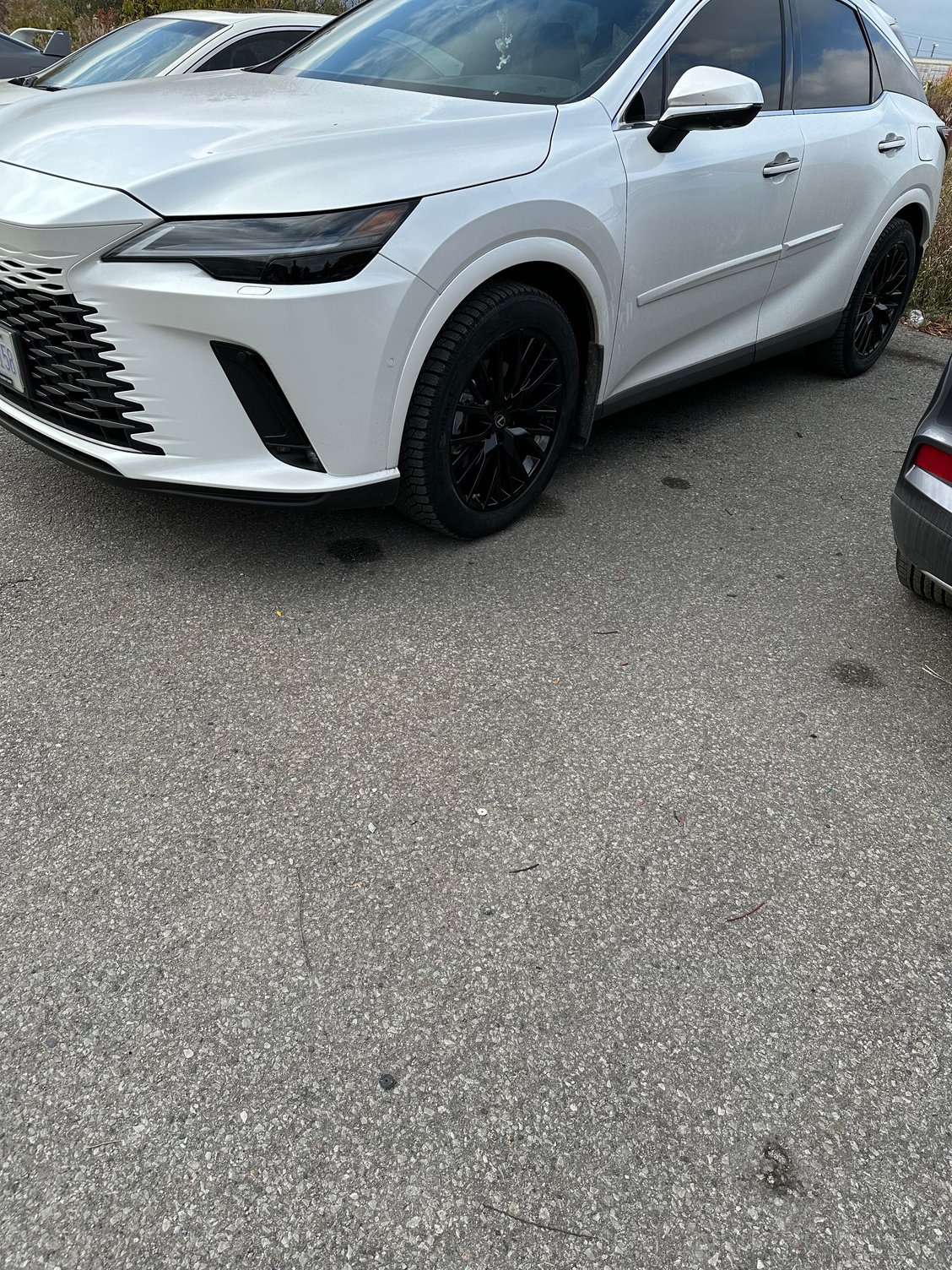

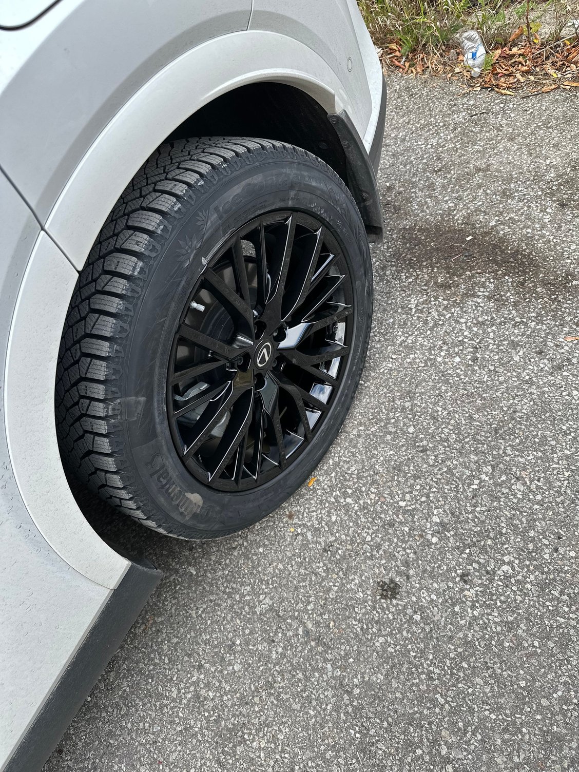

OK so after going back to the tire shop to return the original rims/tires, this is what happened:
Firstly, my dad's RX is the 350h with the 21" pacakge.
The rims we ended up going with are the RS DR3, size 19x8, 5 x 114.3, gloss black which uses the factory lug bolts. 19" was minimum size required to clear the calipers.
Tire wise, we went with Michelin X-Ice snow 107H, size 235-60-19
The tire shop also included hub rings for proper fitment
Unfortunately, they had one of the wheels installed backwards so I need to go back Tuesday to get it flipped. I'll install the tires on my dad's RX after and post pics.
