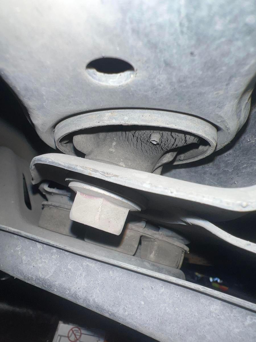

So the shop inspected my control arm bushings recently and said it needed to be replaced in the near future. However, replacing the control arms require removing the motor mounts/engine so it would cost around $2200 to replace including parts and labor. I have already replaced the lower ball joints, outer tie rods, and sway bar end links. However, my budget isn’t enough to fix the control arms as a whole. With the pictures attached below, how much longer do you think I can hold out with the old control arms?

Looks like normal wear. Those are tiny cracks, there are no major tears. That is how they look with some age.
If it drives okay then leave it alone and save your money. When you have a real steering or handling issue, go to a different shop for inspection. I would not trust those guys.
I don't think the engine needs to be removed to replace the lower control arms. It is not that difficult if a mechanic is experienced working on Toyotas. There is a youtube video of a guy doing it in minutes. It helps to know which motor mounts to loosen to get some wiggle room.

Gotchu. What is a reasonable price range to replace these arms? After reviewing what the shop would charge me, the $2200 includes motor oil, trans oil, oil filters, which. tells me they are literally trying to remove the entire engine!!! Which is ridiculous.

I have no idea and such prices vary depending where you live. You should find a Toyota specialist repair shop and get a quote if you want to spend money on this when you don't need it now.
Use Yelp or Google to search for reviews of local independent Toyota specialists.

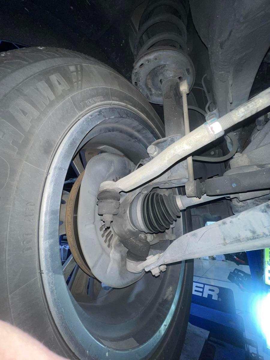

Okay. Here’s the picture of the ball joint that is seeping grease.

Keep an eye and if it develops play, replace it. The OEM are sealed and do not have a grease nipple, so there is not much you can do about it. I love the design as one end is attached by nuts and bolt.

I have similar (possibly slightly worse) wear on my control arm bushings, and was also quoted a similar amount when Lexus noted it as an advisory. My undertstanding is that is that it's perfectly normal wear and that they could last years before they need replacing. Since being notified I sprayed them with AT-205 (I guess a silicone/rubber safe lubricant would do the same) and no mention was made at my last service.

Agreed -- normal bushing wear at this point. Save your money and just keep driving. Inspect the bushings at every tire rotation and if you see nothing worse than your current small cracks, no need to do anything about it.
