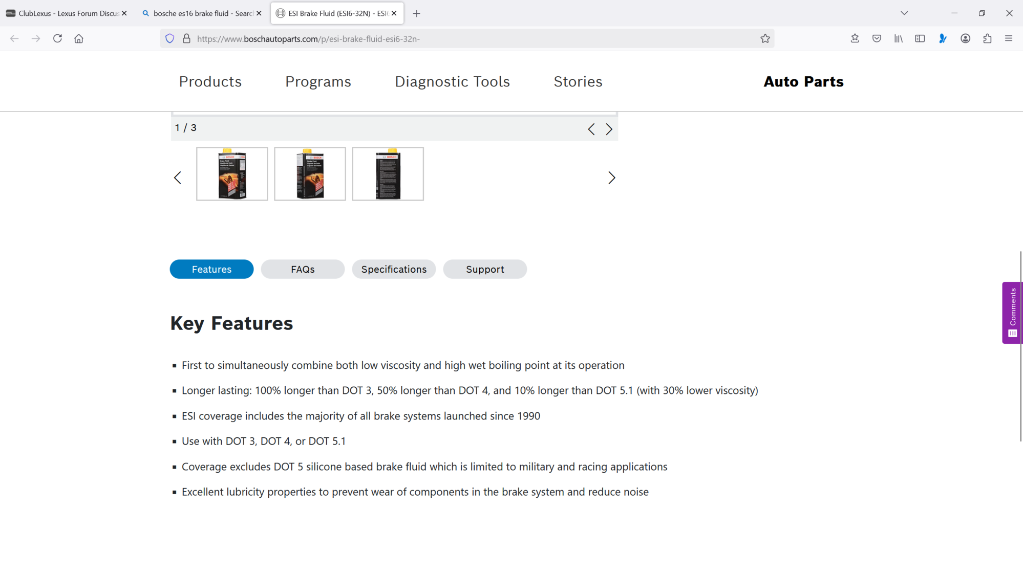

I used Bosch ES16 brake fluid in my 2015 RX350 which is suppose to be an upgrade to DOT3 , DOT4 and DOT 5.1 brake fluid. It works, but I cannot confirm if the upgraded brake fluid performs better than the stock stuff.
I use Bosch ES16 brake fluid in all my cars.

The Bosch ES16 brake fluid is supposed to be able to resist hygroscopic water absorption better than the normal DOT 3 and DOT 4 brakes fluids for a longer service life of about 3-4 years before needing to be changed compared to about 2-3 years for the DOT 3 and DOT 4 brake fluids. Very good brake fluid that is worth the extra cost.
