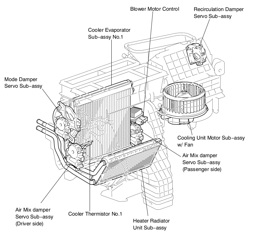

I have the same noise and it drives me crazy. lol
It goes away if I change the mode to different vents or recirculate button so thinking it might be the "mode damper servo".
Totally forgot about it cuz I don't hear it if I change modes.
Looks like it is buried in a god forsaken place deep in the dash but I haven't dug into it so maybe has easy access somewhere- hopefully someone knows.

I have this as well but you need to completely strip the dash to get to it. If the clicking is on the passenger side its much easier to get to apparently.
The fault is the end stop contact on the motor, they basically gum up with dust and when the contacts are made they don't actually make the circuit to stop the motor.

I went ahead and ordered an aftermarket servo on ebay for $30 because oem was almost $200 INSANE!
Was hoping someone does walk thru with pics before I dive in there so I can see if I want to fool with it. lol

Yeah I'm hoping I can sneak it out of there by removing the trim around the gear shifter and reach back up in there.
Any further than that it's a big commitment. lol
