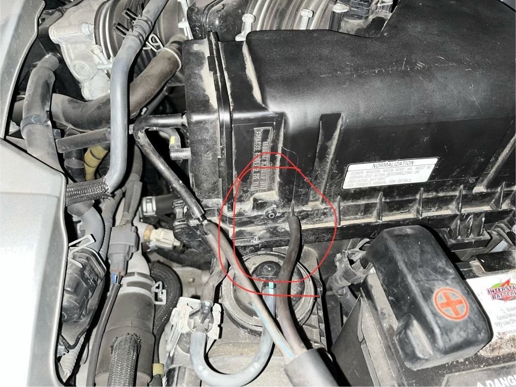

Default I broke the tube as well. What is its purpose?
I laugh as I could have written the first post. I had the exact thing happen when I tried to change the filter myself. I broke the tube as well. I like the suggestion of using the straw, but in the meantime, does anyone know what is the purpose of that tube? What happens if it is not connected? The check engine light did not come on, so I assuming it is not too ominous.
Thanks for any insights.

the washer on the bolt slides into a slot. if the washer is not in the slot, the bolt will not reach the thread
