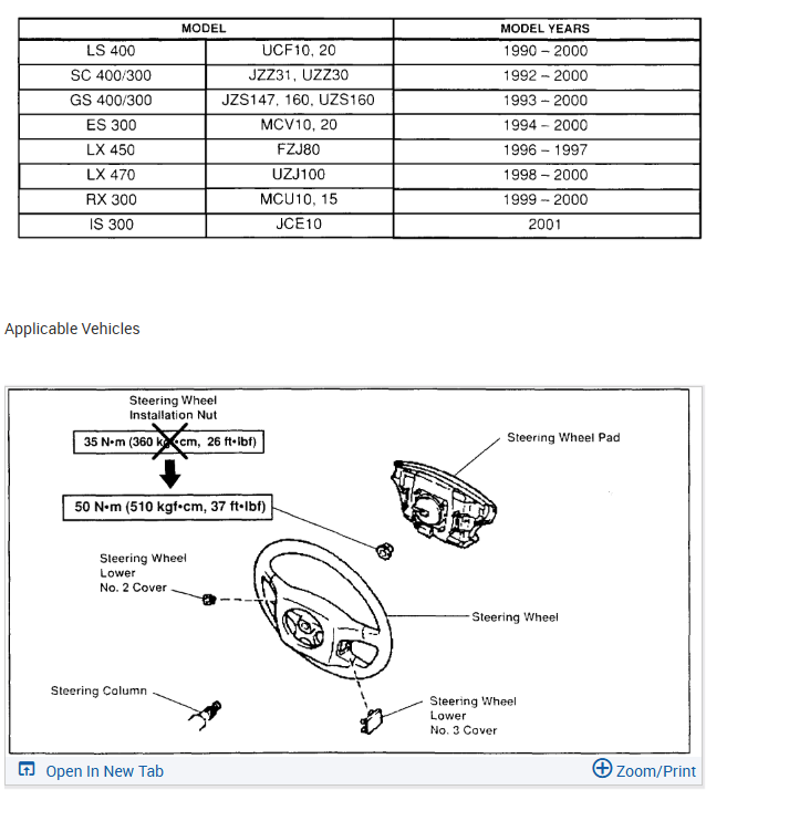

It's a long shot but worthwhile to check the steering wheel nut torque.
