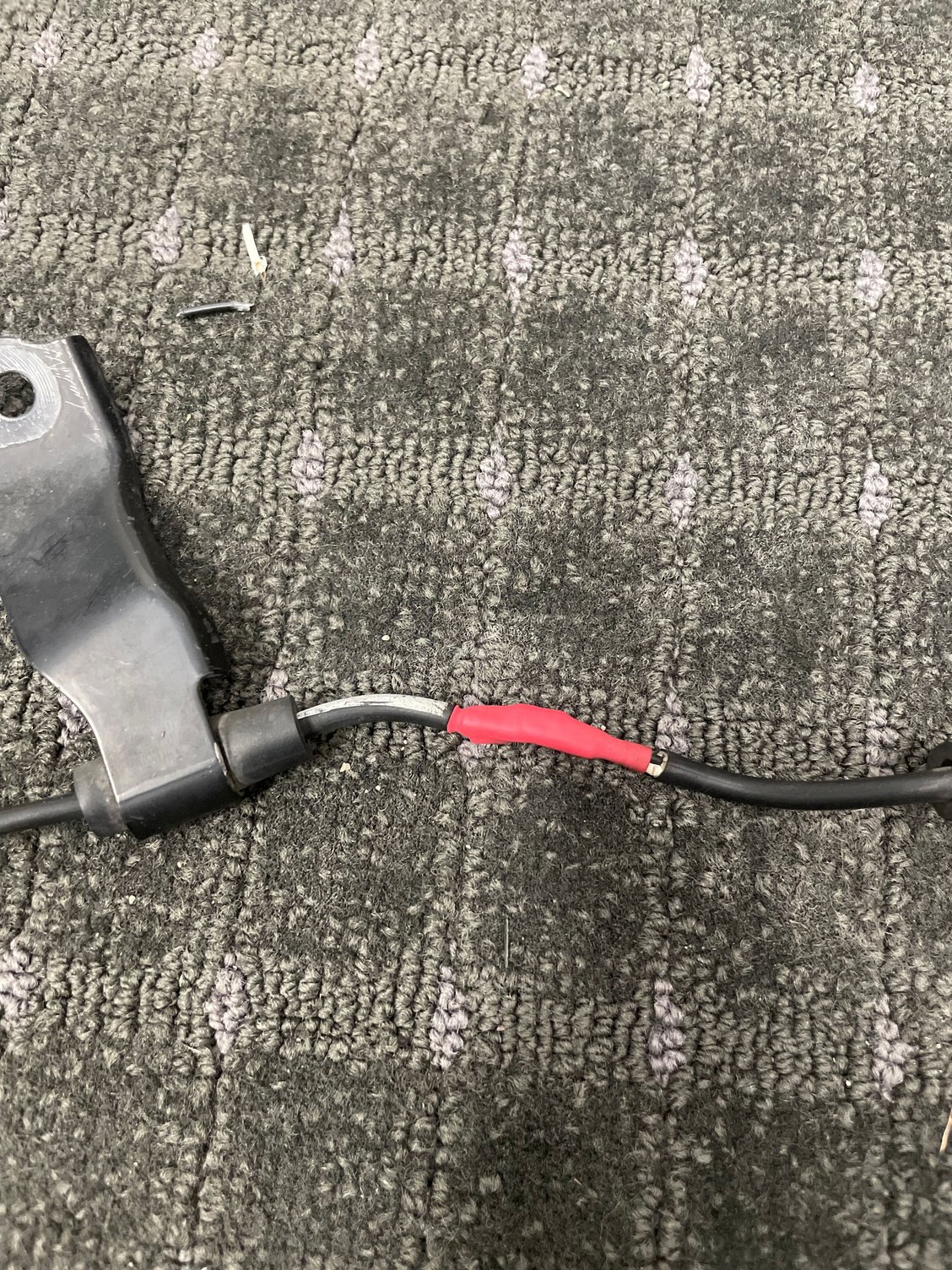

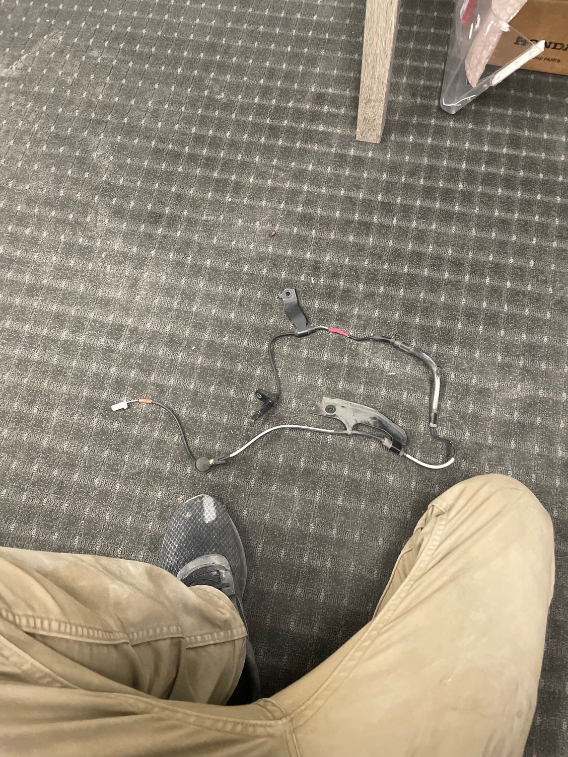

Update: Used a scanner and checked for abs fault codes. sure enough there was a code for the rear left hand (driver rear) wheel speed / abs sensor. After researching how much they cost I inspected the abs wire after taking it off the car.
i noticed a 1/4” long soft / stretched part of the wire. I cut it open with a razor blade and both the power and ground wires were torn within the outer rubber. I reconnected the two wires and heat shrank over it and put it back in the car and immediately with an ecu reset or driving the car ever light turned off on the dash. All is good .

Nice work! Using the heatshrink on wires that get concealed is the best way to finish off that repair.
