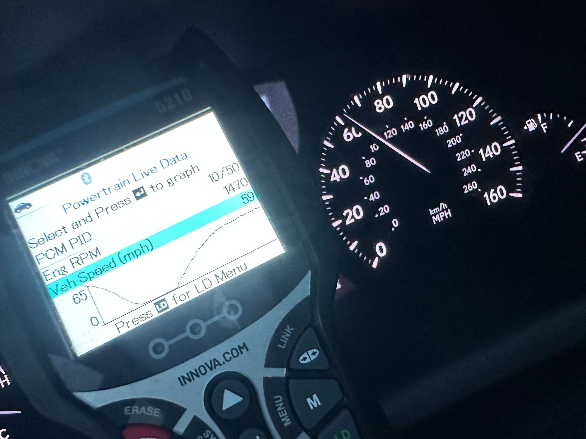

I tried logging this with my scanner and noticed two important factors. At steady cruise, the scanner and speedometer were about 2–3 mph apart (for example, 61 mph on the dash vs. ~58 mph on the scanner), which lines up with normal factory calibration. During acceleration testing, the scanner’s vehicle speed PID updated much more slowly than the speedometer, making it difficult to use for accurate 0–60 measurements. On video, the scanner was still showing around 44 mph as the speedometer approached 60, then continued updating toward ~58 once speed stabilized. Because of that lag, I didn’t consider the data reliable and discontinued the test.

Well no offense but I have a "slightly" better scanner so my data stream is way faster lol!
Most should just use a draggy as a $5800 scan tool is a bit expensive if you aren't using it for other things.

Well “use a scan tool” is misleading when it only works properly with a $5k+ professional unit. Most people don’t have that. If that had been clear, I would’ve just used Techstream.
