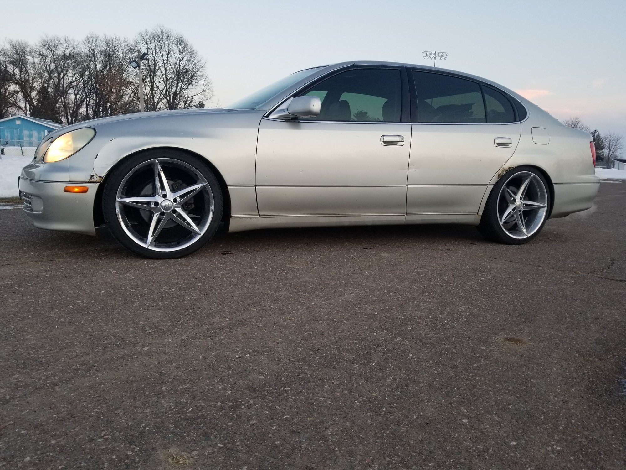

Lol thanks, it does appear more sporty. I'm not terribly sure what models they are but one set of tanabe springs is df210, i think that's the front?
Anyway, it's a very smooth stock like ride with the KYB GR2s, which I'm happy with. What I'm not happy with is the negative camber. I realize it's nothing like some cars on here, but I'm super paranoid of screwing up one of my wheels, or eating the insides of my tires. Today i pushed the rear camber adjustment bolts all the way in to gain back as much as possible. Still leans in some.
Maybe it's a non issue, I've been reading that toe is more detrimental to tire wear than camber. Either way, my steering wheel is crooked now, so i need an alignment.

If you're looking for performance you should go for something conservative like -0.5° front and -1.0° rear. A small amount of camber is not going to wear your tires out much faster and like you said toe is killer. Even a small amount of toe will destroy tires in no time. Depending on what tires you have I've gotten over 30k on a set of performance tires like conti DWS with camber settings like that.

I got the beast aligned today, guy says i shouldn't need to buy adjustable toe arms, but camber arms yes. With maxed out settings, I'm at -1.7 front for both, and -1.9 and -2.1 in the back.
Gonna be searching for adjustable control arms and re do the whole suspension with new parts.
Body is at 225k miles after all...
