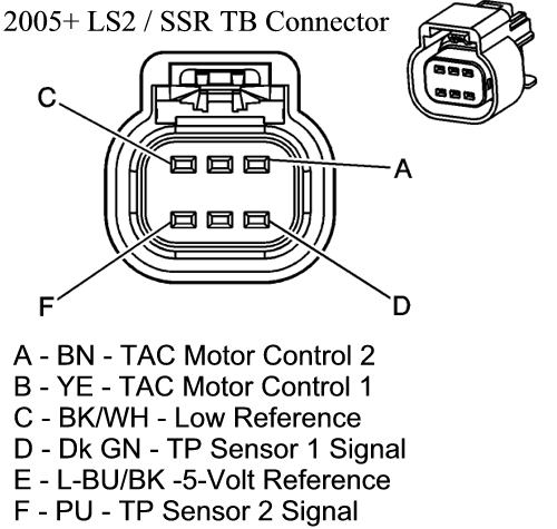

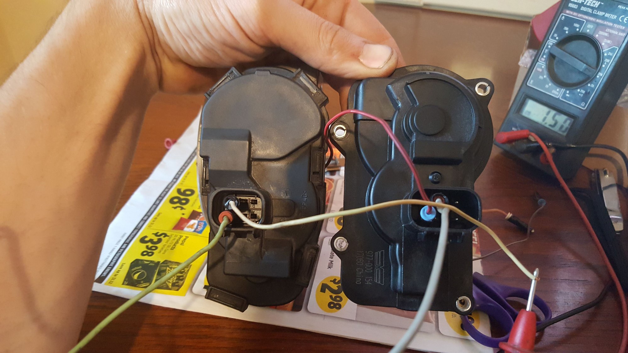

Trying to adapt the new throttle body via re-wiring. I have to at least fail this before I move forward to bolting the little TB on the new manifold. There's an easy way, the Dr. X harness, that will plug in and make this work for $250. I refuse to pay that.
Taking some resistance values from the TPS sensors on each TB module, I found that the 2004 and 2010 TB's are very different.
2004 TB
TPS 1 Blade open5650
Tps 1 Blade closed 630
Tps 2 Blade open 5650
Tps 2 Blade closed 630
2010 TB
1 blade open 1660
1 blade closed 3130
2 blade open 2240
2 blade closed 817
Values are measured in ohms. By my measurements you see these two have TPsensors that have very different ranges.

it appears simple. just put both five volt references on the same wire and do the same with the low reference. than just match the pins.

I understand that your getting different resistance values with both throttle bodies as you sweep the angles. But the computer isn't looking at ohms for reference. its voltage sent thru the beginning of the throttle position sensor and what it reads as it makes its way across. not the throttle control motor might be different, but based on what they look like on summit racing, its just wire in the harness. no resistors or diodes. so get crackin'

Well I did hook up the wiring actually. I went wire to wire and left one pair of 5v and a low reference out. Turn the key on, throttle cycles once and never reacts to any input. Swapped to the other 5v and low ref and same thing.
I vaguely understand the pcm is looking for varying voltage, but measuring resistance should still give me an idea of what needs to happen. Altering these values with resistors isn't gonna cut it. I'm not sure how I'd go about recreating the 2010 resistance values. One goes from lower to higher and the other higher to lower, wtf??

they go lower to higher and vice versa for safety. if at any point in time the voltages don't match five volts with both added together the car goes into default. its because of the drive by wire. it only takes a little bit of high resistance in the circuit or a breaking wire to throw the car into limp mode so that it doesn't just go wide open throttle like the prius' did.

No you read that right, I did not try pairing them together. From continuity checks, the new 6 pin style just uses one 5v/low for both tps circuits. I guess I was more focused on the tps circuits. I'll try pairing the references and 5v together just for kicks.
I was guessing the TAC module saw voltage readings way outta whack and faulted out. I ordered a cheap dual gang 10k potentiometer on ebay today. Thinking maybe I can finaggle my own tps sensor into the new throttle...
I have no idea how the Dr x module works. Little circuit board that reads voltages from throttle, then spits out the correct voltages the tac wants to see?

Ok I've had some crazy ideas before but it just dawned on me... Why do I have to use both values from both tpsensors? If both values are the same in my old throttle, why can't I just use the one tps that had the 817-2240 range and hook both position sensors to it? The low end is very close and I might be able to modify just the high end.
I'm probably wrong but that sounds like it might work

Well I tried tying the 5v and low ref together and first the throttle blade would shutter back and forth super fast for about 30 seconds and quit. Then it went back to just cycling once and still doing nothing. Also tried the one tps plugged into both tps pins, also no dice.
