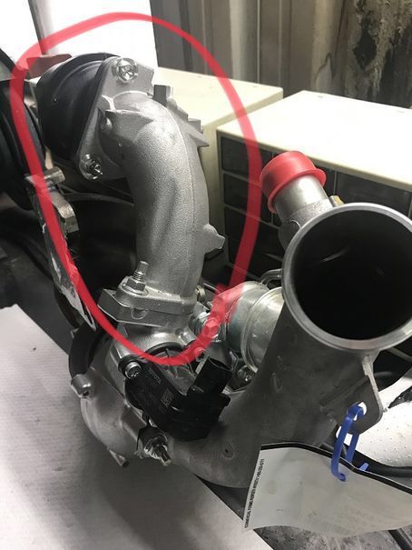

Originally Posted by Sheddy
Turbo muffler delete added, car is running like a champ!

How difficult is the turbo muffler dleete to install and is there a significant sound difference? I can’t tell from the posted video
It is not difficult. It requires you to disconnect a bracket to get access to the upper part of the turbo housing with the OEM turbo muffler and removing the coupling to the charge pipe. All accessible from the engine bay. It doesn’t make a noticeable difference with the sound, but it does help with the air flow to the charge pipe and intercooler.
