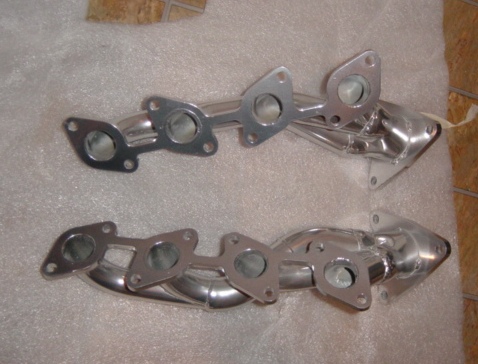

Got the headers in today and they look very nice, the jet coating makes the entire header ( inside and out) very,very smooth. I gotta say that the quality looks very nice and the workmanship is very good as well. Price was 598.99 + 14.50 shipping/handling.
I spoke with the fabricator when placing the order late last week, very professional and talkative guy(the guy has been making headers for almost 4 decades ) He suggested that the left motor mount with have to be removed to get adequate access to the driver's side manifold. I'll guess we'll find out in the next few days, I'll post the pics of the install afterwards. Until then, Check out the pics
