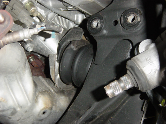

Motor mount screws
Mounts undone and partially dropped - Look how tight it is to the heastshield
Oil dipstick stuck between OEM headers

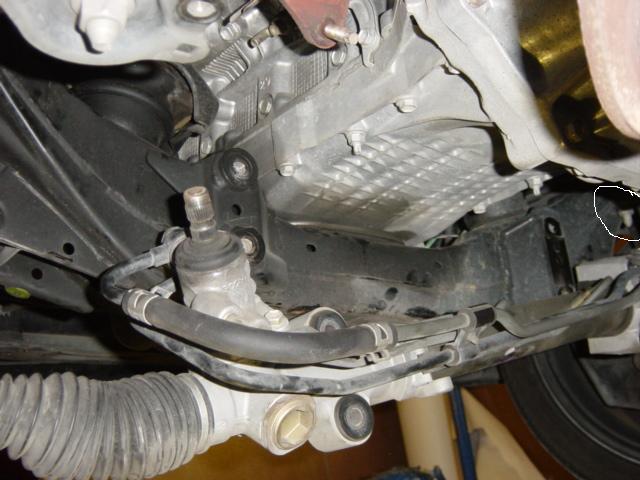

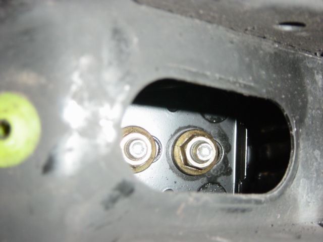

Steering rack mounts 17mm - 2 on each side
Still assembled
Disassembled
Circle bolt is one of the 4 that belong to the front subframe
Toyoda - My car was made by Lucas Films
My exhuast leak
