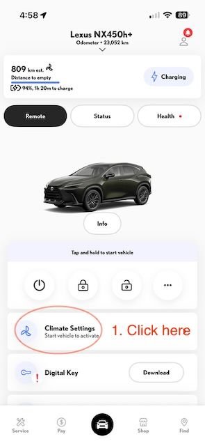

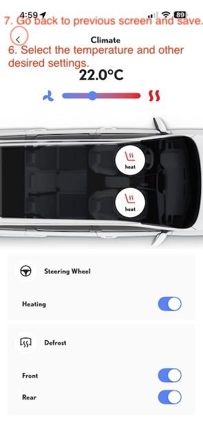

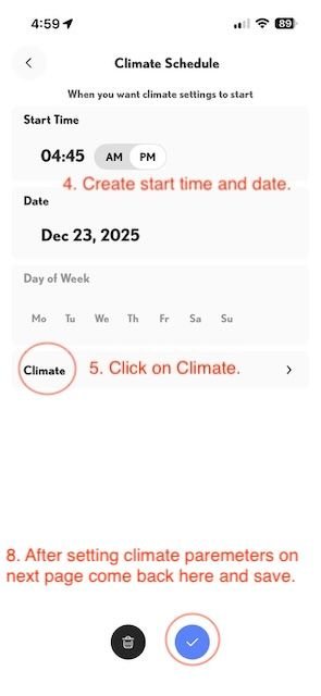

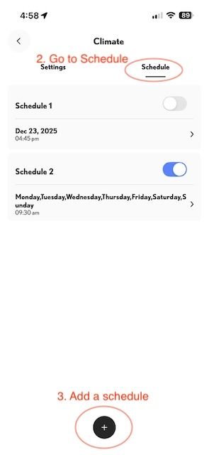

While plugged in you can set a 'one-time' precondition schedule. This should work if the temperature in the garage is above -12 deg C.
I usually do this about 30 minutes before heading out as this will operate for thirty minutes instead of the twenty minutes with remote start.
The climate settings for this schedule are different than the settings that you have set for remote start.
