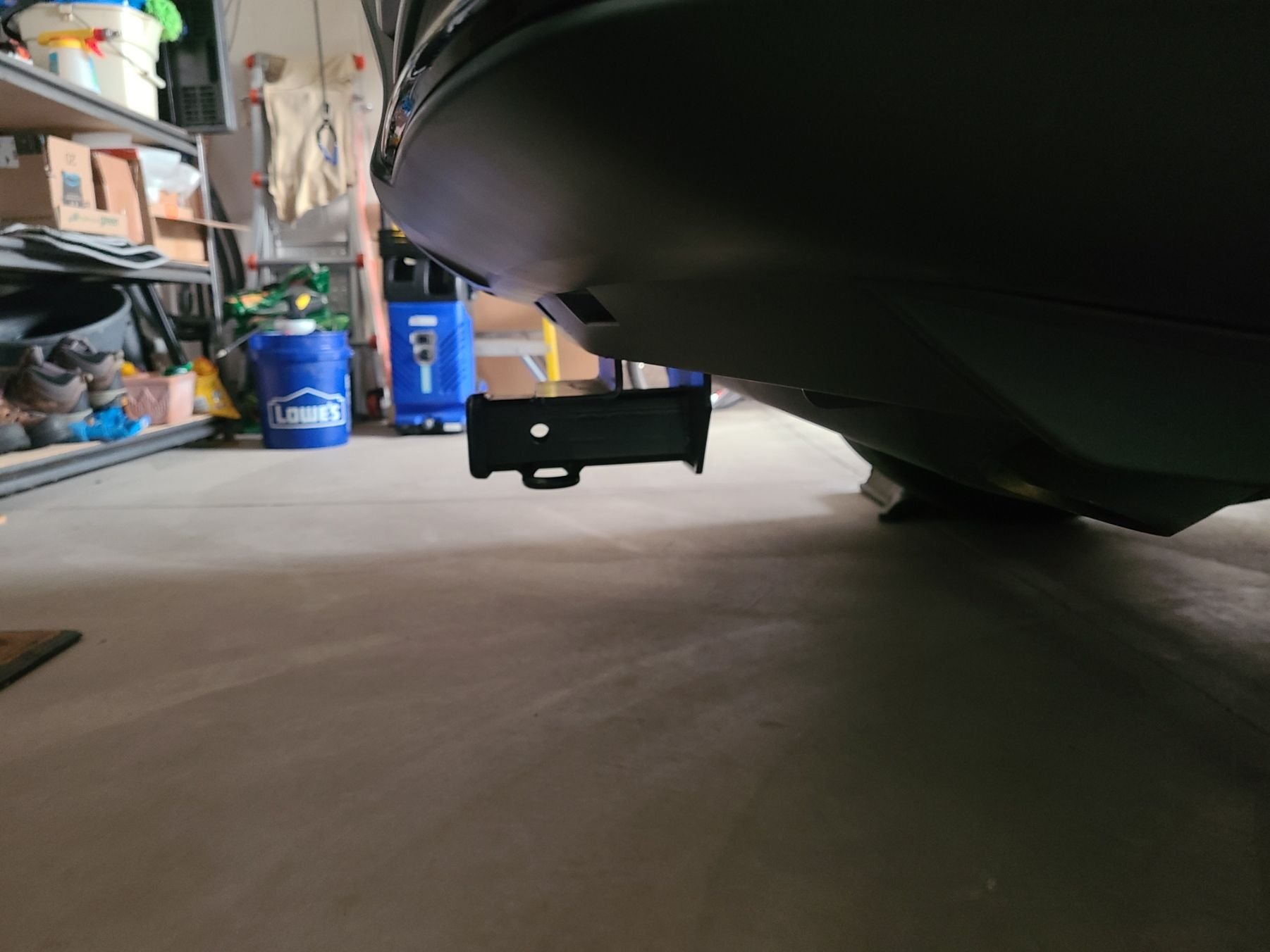

I had the 76201 installed by a local hitch installation specialist. They have a funky hoist that tilts the car up at the rear making access for the mechanic a breeze. They did remove and reinstall the exhaust system. 2nd NX they did in a week, many other Rav 4's; it's the same application. Price including installation was less than just the hitch from Hitchweb, so for me was a no brainer.
Not overly thrilled with the final fit, though. Seems to hang down a lot under the bumper cover. Appears to have been designed for the Rav 4, mine was made in March 2022, in Mexico. Have learned to live with it. Will be used for my Thule bike rack only.
Also, the kick sensor works, but not reliably. Good thing there are 4 other ways to open the hatch!
Note, mine is a 350h. But all NXs have the same subframes.

These aftermarket hitches are excessively low hanging, compromising the ground clearance, and they look unattractive too.

Can't argue the less than ideal look, but haven't had any issues with ground clearance.
