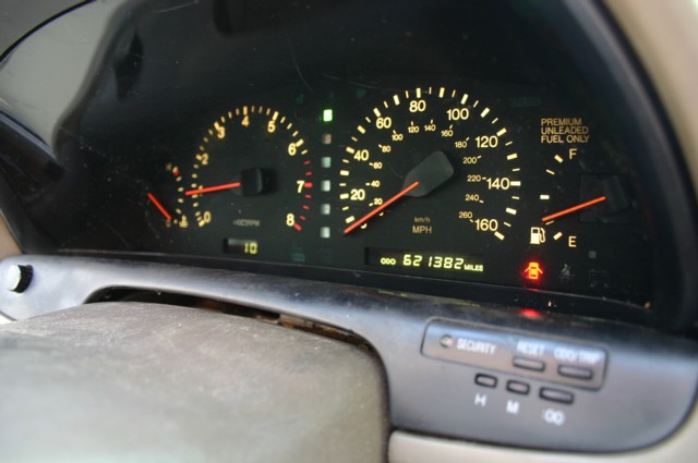

Originally Posted by VegasSC300
307,000 miles "that's incredable"

Originally Posted by O. L. T.
Is that on the original motor?

OK you said the car has 307,000 miles but the mileage indicator says 621,382? Did you get a new engine in between, maybe a rebuild?

2 different people posted that... lem321 has 307, o.l.t. posted 621
