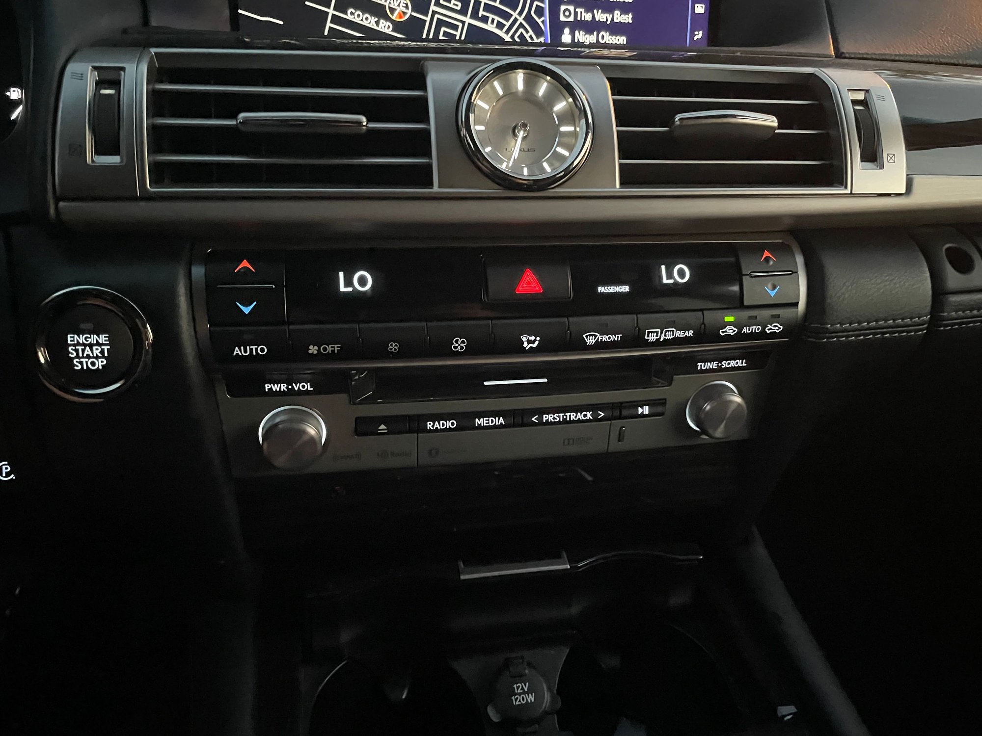

Within the last week, I noticed the following 3 lights in my dashboard are out:
-Eject
-Fan off
-Fan down
I have a 2017 (had the car for 46 months) with 47,000 miles, so I assume this isn't covered by a warranty. Anyone else seen this? I assume it will be expensive to fix due to the labor.

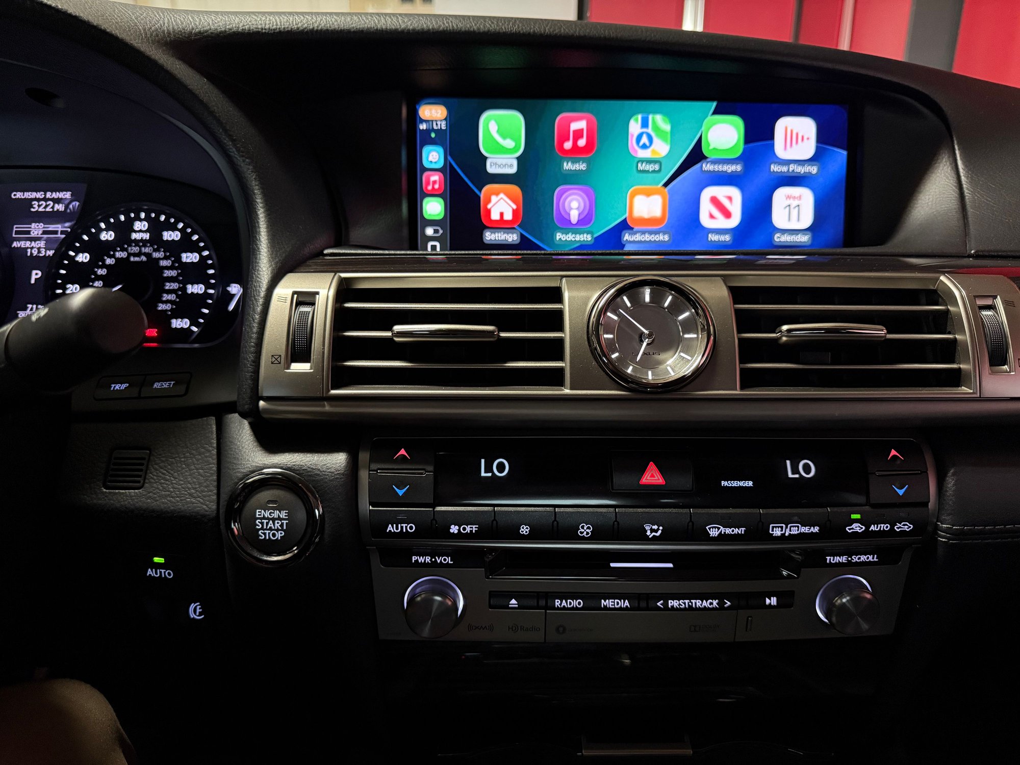

**UPDATE**
I got my radio head unit back from Tanin Auto, and they did a great job of replacing all the LED backlights. Their website link for the service gives a warning that the color matching will not be exact. But I was actually impressed with the color matching - notice how close the color is on the head unit to the Engine Start/Stop button and Auto parking brake. It has basically the same very light blue hue to them. Very pleased.
The turnaround time was about 3 weeks total, including shipping both ways from California to Wisconsin. There are expedited options.
