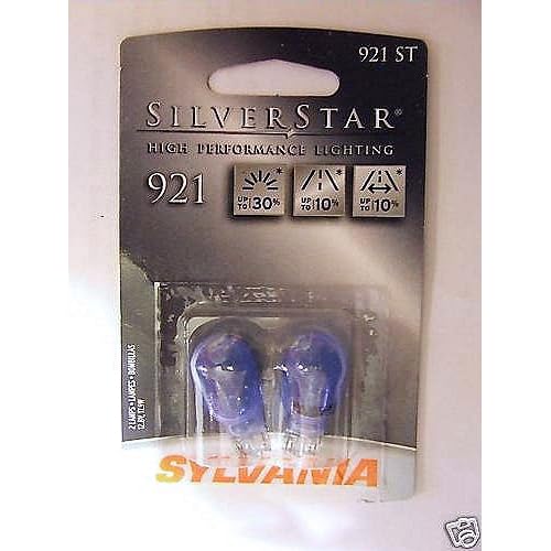

Originally Posted by CJITTY
Thanks. When I was at Auto Zone, I saw the sylvania silverstar 921s also for about $10 a pair.
I was tempted to get them and see how they look since we had the cars torn apart again. Was wondering how they would look if I wanted to have them blend in with my 4100K HID headlights, but imma cheap baassaad so I didn't get em. But I may try these for the front domes. They should fit, may be close though. The benefit to these is getting back the true light fade out that the LEDs cut short.
anybody think these would be good replacements for reverse bulbs?
Old Sep 19, 2012 | 05:04 PM
  #191
SBlexus's Avatar
SBlexus
Joined: Jun 2012
Posts: 645
From: Fl
Yes, i have those in my car and I also tinted my lights and they still looks bright.
