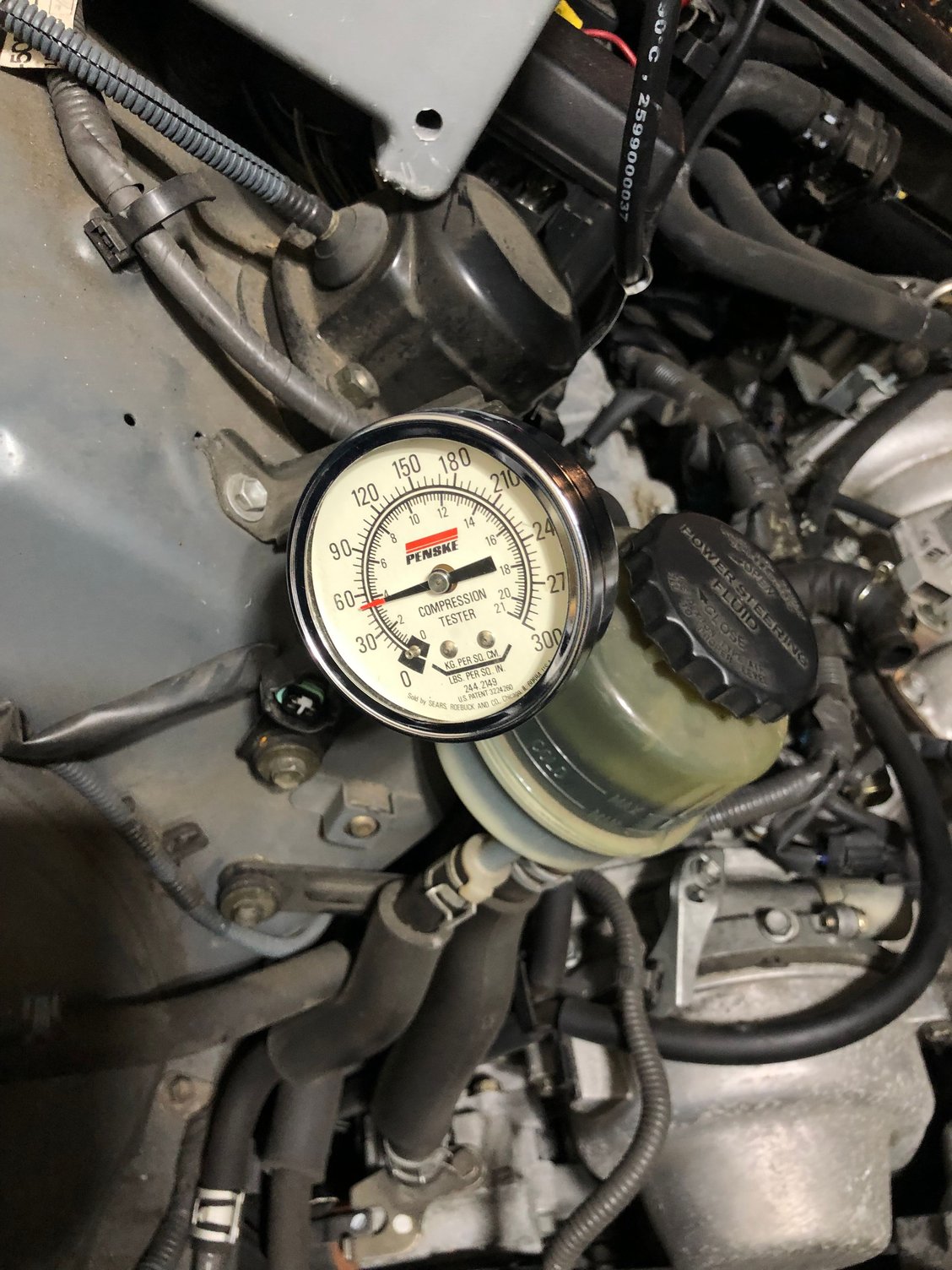

Update. I did a compression test, all cylinders on driver side are normal and in 200 range. However on passenger side, all are only at 50ishpsi.

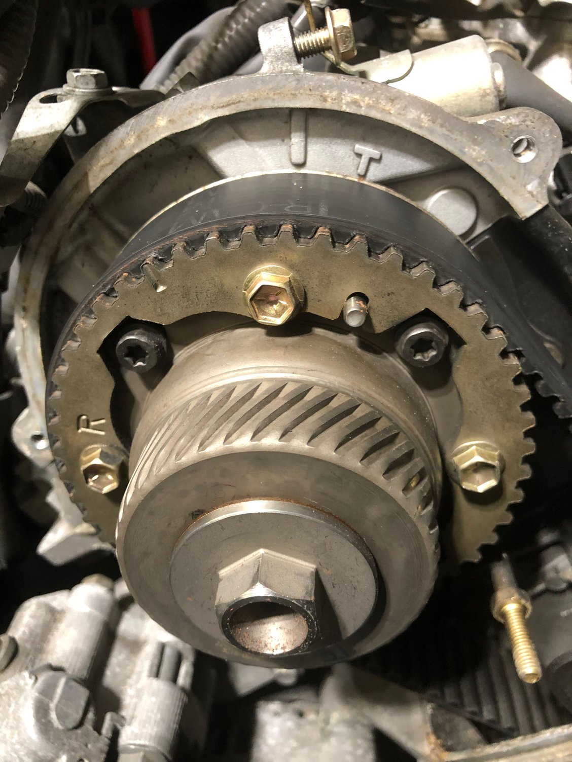

I removed timing covers, and on the passenger side the timing is off by 5 teeth and about a tooth on driver side.
The belt looks in fine, no signs of broken teeth and the tension is tight. Not sure how it could have jumped.
should I retime it and see if it fixes compression or is the bad compression already a sign of valve/ required head work?

Old Mar 18, 2022 | 02:04 PM
TominPT's Avatar
TominPT
Joined: Jan 2018
Posts: 965
Likes: 299
With the cam and valves out of time I think you have head/valve work in your future, unfortunately.
Old Mar 18, 2022 | 10:06 PM
13101093's Avatar
13101093
Joined: Sep 2019
Posts: 143
Likes: 45
From: Western Australia
If I am not wrong the marks on the belt are only there for installation, once they have been rotated the marks wont line up anymore anyway.
I would be suspicious of the belt jumping if everything looks fine but loss of compression on one bank is strange, you are ensuring at you are a TDC for the test?
Old Mar 19, 2022 | 07:07 PM
Posts: 18,096
Likes: 1,740
I assume the timing marks for the other cam and crank are at their correct positions relative to the marks on the engine? If they are then you likely killed that engine
Old Mar 21, 2022 | 01:37 PM
EV02is's Avatar
EV02is
Joined: Apr 2009
Posts: 107
Likes: 11
Yes they are
