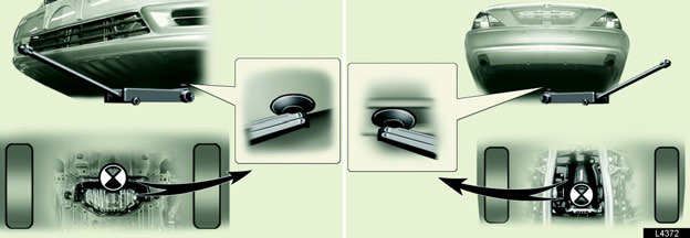

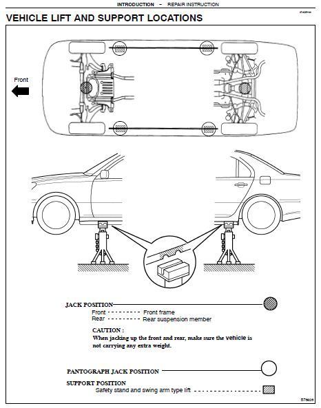

i tired to jack up rear end to take a look, only to find factory jack isn't very suitable. i couldn't find a rear site to put sizzor jack . it has a slot to grasp a pinch point. works fine on front end. every thing online say jack up at differential but sizzor jack seems ill suited for that.
DO NOT use the scissor jack on the differential. Use a floor jack under the center of the housing ... shown at the end of below video
Originally Posted by 430SLOwner
Lifting points
Originally Posted by rkw77080
