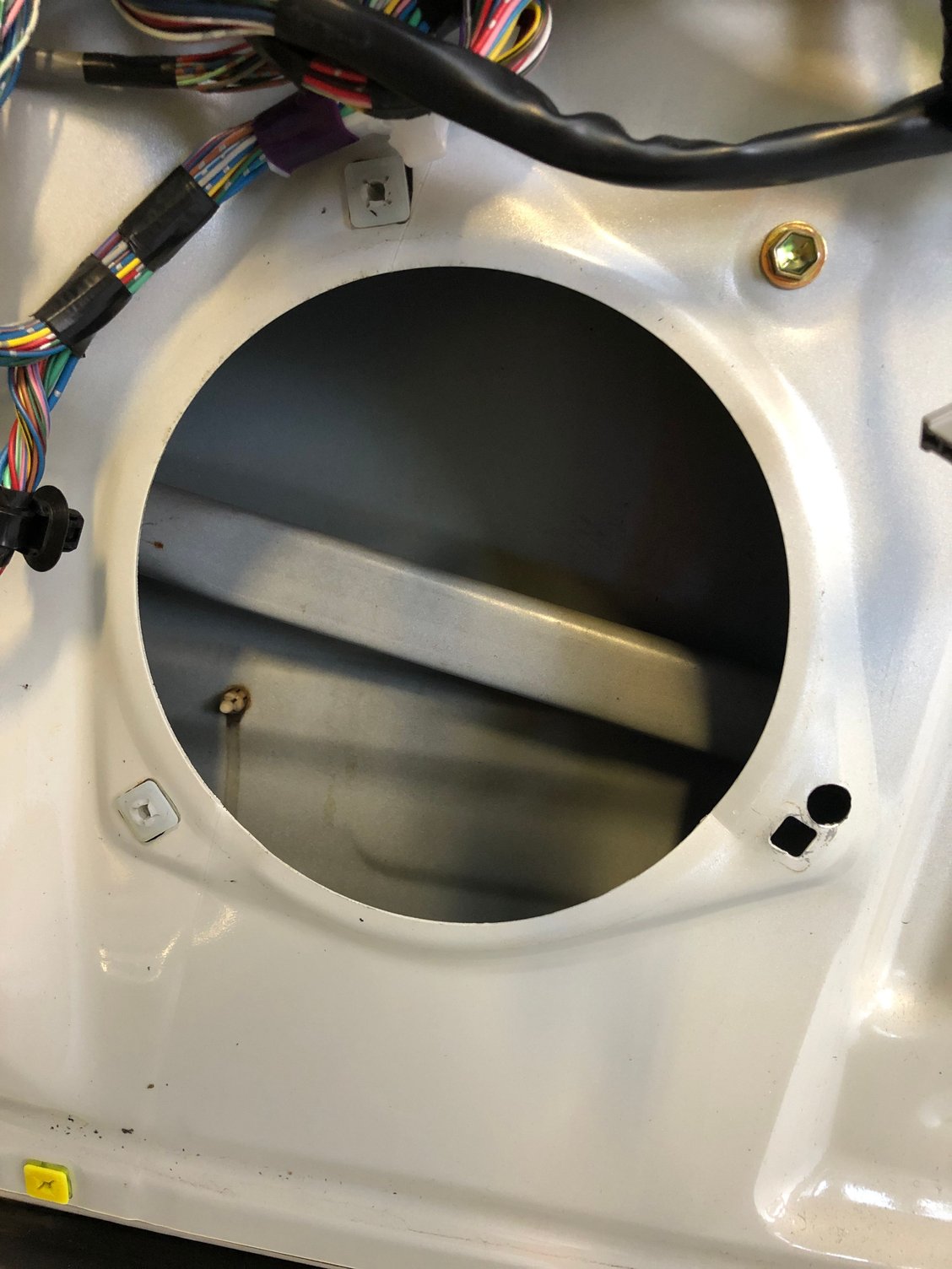

well after a few months of ordering, receiving the wrong bits, and getting re-sent the right bits and now finding time to install the job is complete.
2 ohm front speakers
used standard toyota - 6.5 inch adapters but required moving one of the mounts, I drilled an 11mm hole in the spot which was good enough to take the square mount and stay in place.
I then raided the old speaker for the connector and ran a wire through the nearby grommet.
all done!
