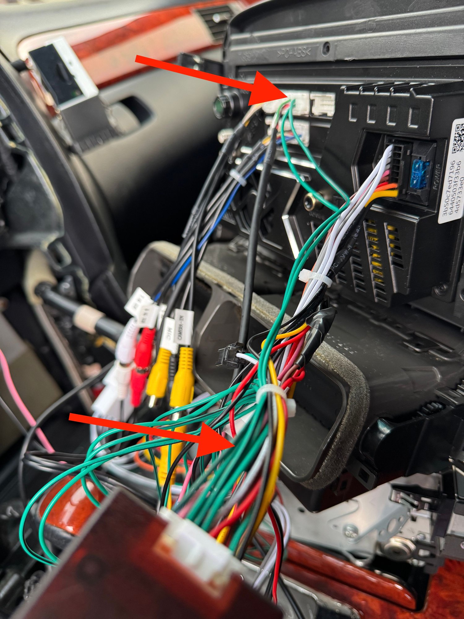

For those of you who have installed the Chinese Head Unit is the Canbus plugged in only on one end? I didn't see a connection that would fit the smaller end. Just trying to cover all my bases. Thanks in Advance.
Old Feb 19, 2025 | 03:11 PM
  #605
70Chevelle's Avatar
70Chevelle
Joined: Jan 2025
Posts: 80
Likes: 61
Yes only on one end.
On Teyes harness there are 2 connectors that fit Canbus. One with more wires is the correct one. There is also a connector coming out Canbus connector with 2 wires that plugs into back of the unit.

Update, I noticed that my rear defrost would not work.These Canbus settings work. I updated the post above.
Mine was both or no sound.

Originally Posted by 70Chevelle
I looked up some info about Kunfine Android and unfortunately there are few people with same issue as yours and nobody posted a solution.
I appreciate your willingness to help. I believe the only way to get the AC app to work is with a different canbus but have no idea which one or where to get it.
Old Feb 22, 2025 | 10:52 AM
  #610
alextv's Avatar
alextv
Joined: Jan 2004
Posts: 1,958
Likes: 480
From: North Carolina
Does your OEM radio work? Steering wheel controls work? Do things change when change cars in can bus? How did can bus come originally set? Have you found a switch in any of your settings for AC function? That switch will give your or any can bus the permission for AC function. Do you have a factory menu and able to get into it? The can bus you have should work and none of these units come with instructions which means customer has to figure out how to make work. Can bus will generally come preset with what will make it work. Have you hooked anything into the top 3 oem connectors?
