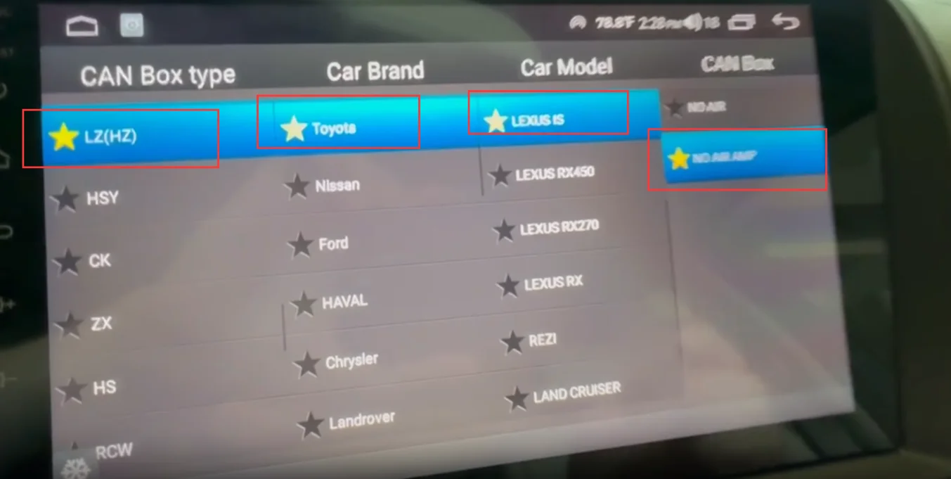

Originally Posted by Nieko21
Any luck with finding the right canbus settings? I have the same problem
Figured mines out yesterday. You literally have to try every CANBUS that has a Toyota car option. Mines was Luzheng-Toyota 12 Crown-HighConfig. Other ones like HiWorld would control steering wheel but not the A/C. You have to connect the unit to WiFi to download a new CANBUS type. Literally was downloading and restarting system until fan controls worked on A/C screen and had steering wheel buttons. I bought a 8gb 256ram from OPUYYM store on Aliexpress. All I have left is to figure out back up camera…

Hi can someone please help me with this.
I bought this unit (EKIY KK5): https://www.aliexpress.us/item/3256802558475382.html
I installed it into a family members Lexus. The LS430 is a 2006 with Mark Levinson.
I cannot, in any way, seem to get an AC control to come up.
I also do not see any way to get into a can bus menu.
Edit: apparently they put these instructions into a message they sent me on Aliexpress (yet did not include them in the package):
If the power cable you used is with canbus, then you need to set canbus. Refer to below steps to set up. For EK2 model: Access in internet first and then please go app named Settings--car settings--extra settings--password 123456/8888--model choose to the photo one.
For KK5/KK3/KK2/KK1/EK5/EK3/EK1 model: please GO Setting app -- Factory -- password 3368 -- Confirm -- Car model choose to the photo one.

Message them through Ali express and they will tell you how to get into can bus settings. They generally respond in middle of night. Might need password for factory settings from them or google. Sounds like the can bus is not set up correctly. All of these units have sections that require a password that are even on you tube.
