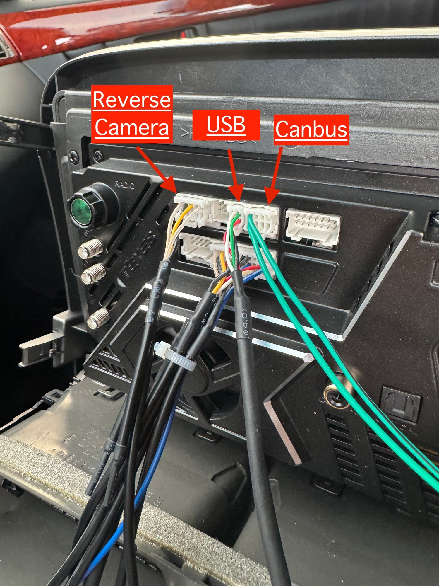

The Canbus says LS460 - so is that the way to do this?
And was the wiring pretty straight forward?
Thx

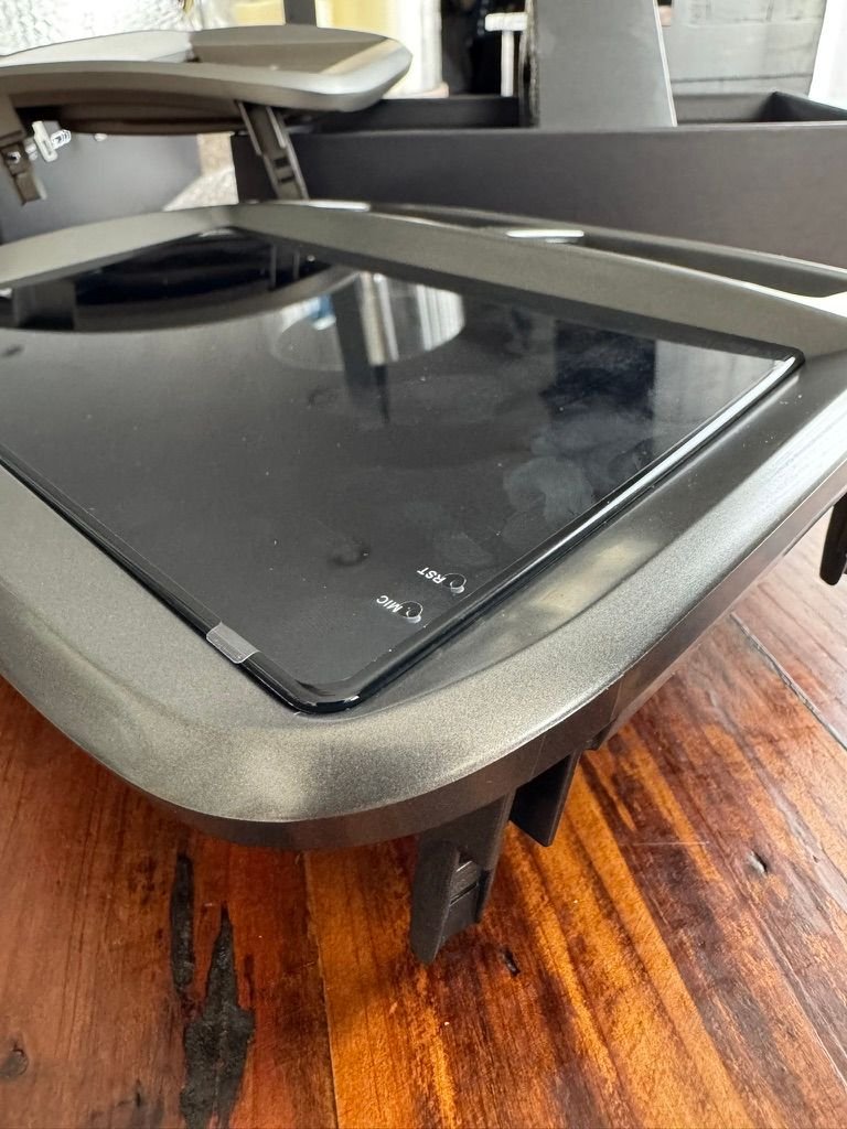

Edit - do you still have the protected screen film on it? That plastic tab at the top looks like the screen protector?
Yes the factory protective film is still on it. I haven't had a chance to take it off and install the new anti glare one.
That is the correct setting for canbus.
Wiring is pretty straight forward, not much to it. Kind of self explanatory. Main harness that plugs into existing harness, CD/Cassette, Teyes and canbus. There is a small connector that's on the main harness that plugs into Teyes. Another harness that plugs into Teyes on one side and has RCA inputs on the other end for sound input from stock setup. Everything else is optional, USB cables, 5.1 output, Except the canbus, 2 plugs that can plug in, and of course I plugged in the wrong one.
Few connectors are not used, I cut and capped those to keep it clean. It comes with 2 USB cables, 3 total USB, I only used 1. Also I didn't use the 5.1 RCA outputs, because my amp is already wired and it works just fine.
It comes with 4g, 5g, and GPS antennas. AM/FM will need to be purchased separately and most likely will need an adapter to plug ti in Teyes. I ordered the adapter.
Spent a lot of time configuring the unit, i'll add everything in my write up. Had to do factory reset, and find the correct settings. Info is out there, but spent a lot of time looking for it and playing around.
Everything works, steering wheel controls, AC, cd player, even the oscillating vents. Sound quality is better than OEM
It's fast, it boots up quick from sleep, few seconds. No lagging on the touch screen, apps open immediately, carplay works.
I'm still tinkering with, trying to see all the stuff it has.

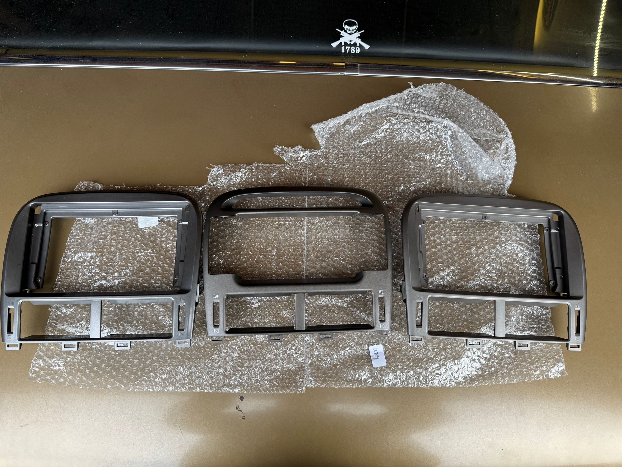

one thing I should mention is that I ordered a different fascia. The one supplied by Teyes is too grey and too shiny. Also the screen sticks out too much. The one I ordered is a better match, far from perfect but better than Teyes, and screen sits flush.
Link to the fascia https://www.aliexpress.us/item/32568...yAdapt=glo2usa
Teyes Fascia on the left.
Teyes Fascia
The one I used.
