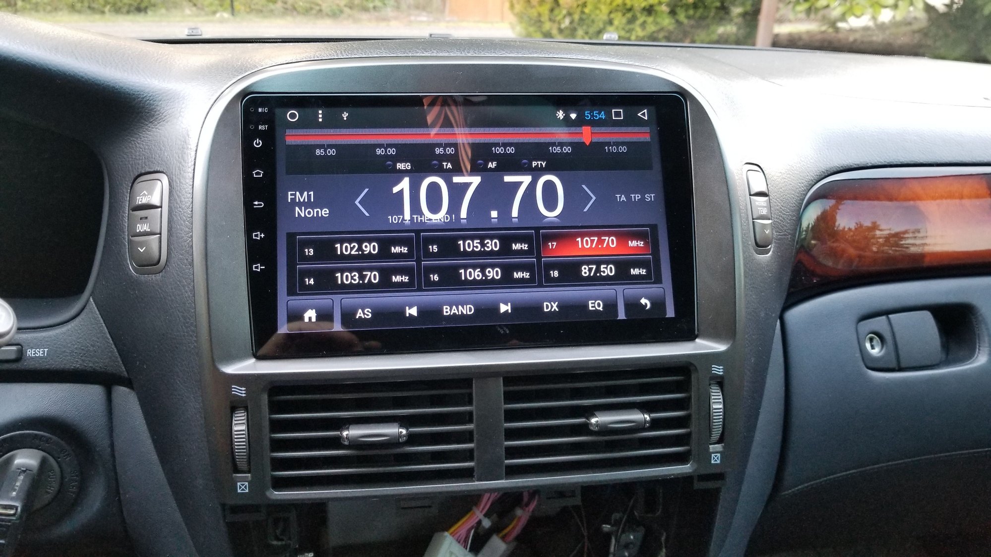

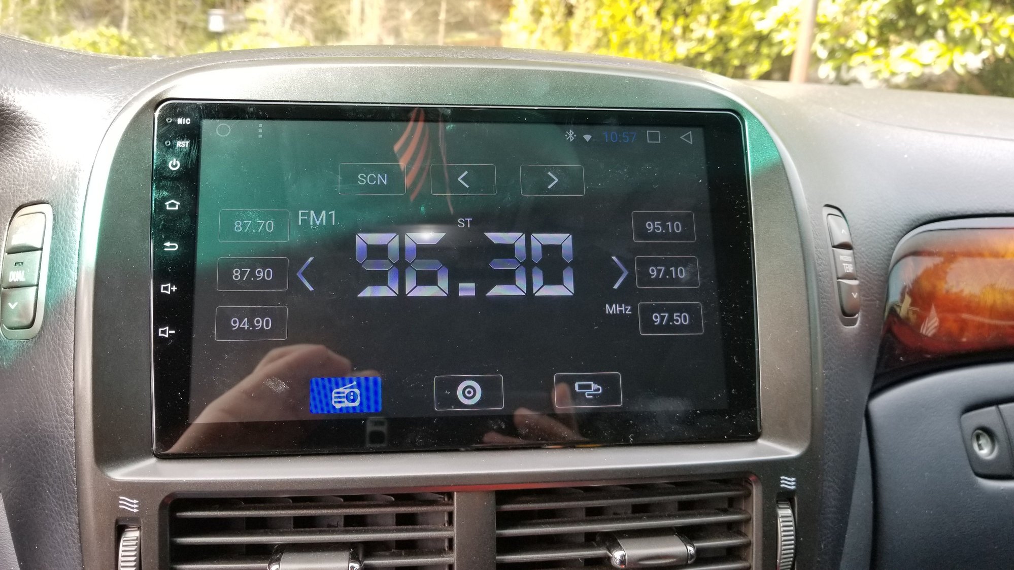

anyone recommend a good off the net navigation app.... or need to improve antena connection for mine... using google maps and sygic.

Originally Posted by m1pnk
so i got this... did i waste my money ?... can anyone confirm fitting to help me... thanks
That is really weird that you're not getting reception as the factory tuner that's in the trunk is doing all of the radio work
Did your factory radio work good before good reception? Maybe that connector got unplugged at the tuner that's in the trunk on the right side check that first
but that is the correct harness that you bought but you will also need about 16 ft of an extension cable going from the trunk where you will connect that harness that you bought to the actual Android head unit
I have not touched anything in the boot and radio worked fine as far as i can remember... i used my android head unit most of the time.... have to see it anything got disturbed... thanks for reply ... i take it its all well and good to run rear cam cable at the same time ..... i do miss that.... and im forgetting things like outside temp... we just lost those ? ... and my sat nav in the boot ... that us now i take it.... thanks again

Likes: 65
if you guys aren't getting any radio on this app - that is ok, it only gets signal if you hook up external (old school) antenna to the unit, or an adapter i guess
the factory wiring sends signal to this app, which is i believe in the "old car" app, or should come up by default after you hit the FM button on your deck below the tape deck
