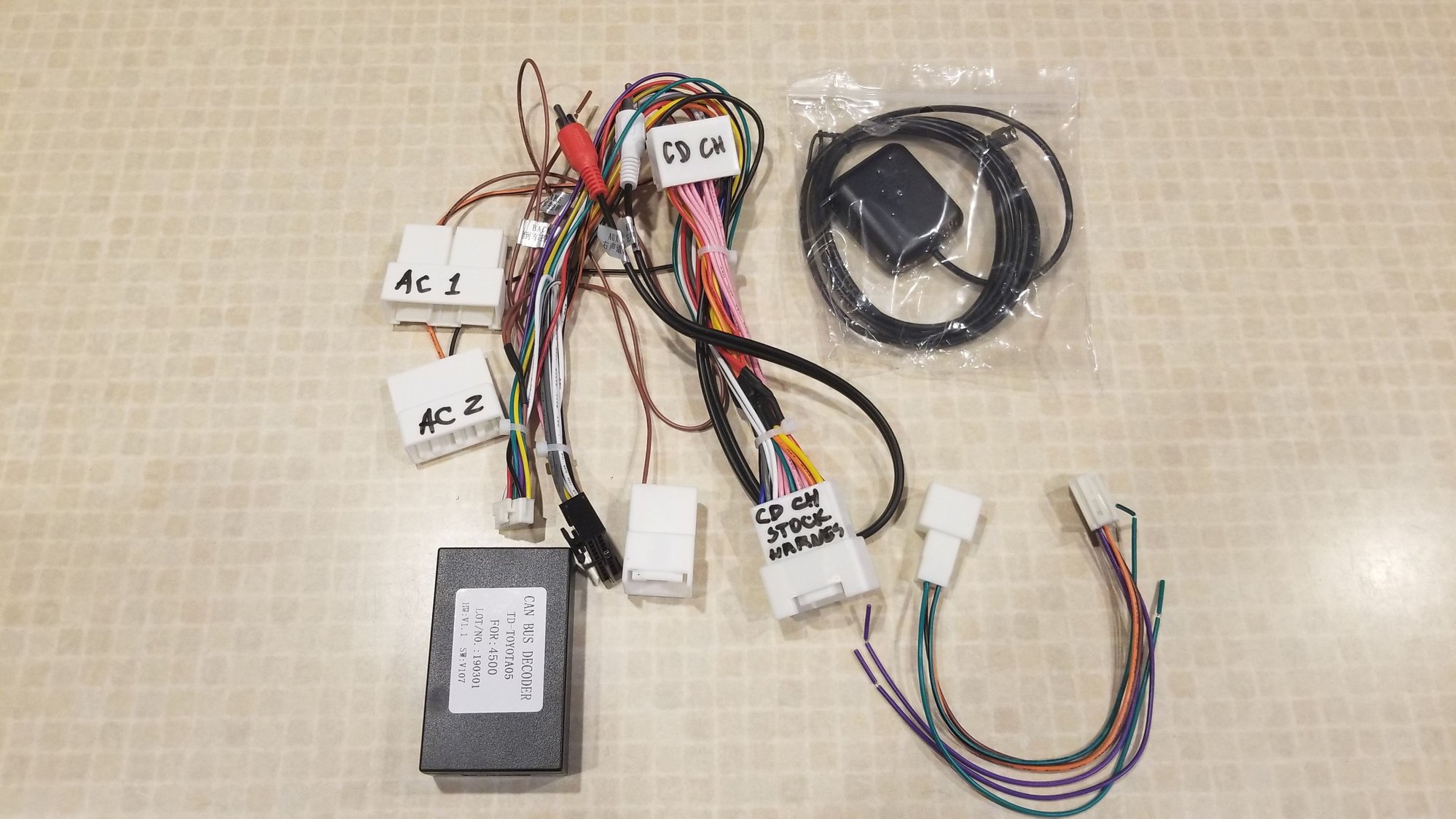

thank you guys for the replies I totally forgot about the RCA's that have to go into the auxiliary end
All works great now this is the cable I ordered for connecting the OEM GPS antenna to this Android unit
The one end is going to be: SMA male - GT5-1S female
I'm 99% sure that this is the correct Spec's I'll let you all know once it comes in a few days I ordered it on eBay
I ordered a 6-inch version of the cable ( apparently the guy on eBay who sells them has 2", 6", 12", Etc
even the 2-inch version would probably be long enough since the OEM GPS antenna has about 5 or 6 in right to the back of the Android unit
Keep u posted
Next step is to run the wire harness through the back and under the air vents and to buy a USB DAC that works with Android since my whole goal really was to have Google Maps and an aftermarket sq audio system

Hey guys so here is the update with that adapter cable that I ordered that goes between the Android and the factory GPS antenna
You have to make a slight modification which takes about half a minute with a file you just have to grind down a little bit of the plastic..... because the Toyota plug is just slightly different but it works fine afterwards here's some pictures
( if you don't grind it down the fit will be too tight and you won't be able to plug it in)
As far as the beeps I'm not sure what you're talking about but maybe in the one of the menus you can turn that off
And completely removing the CD changer I don't think it work because it is the integral part off the system if you remove it I'm not sure how much the car will like that... So who knows?
most likely you will throw up some errors and fault codes I unplugging the cable and I got all kinds of errors but this was still with the factory screen
