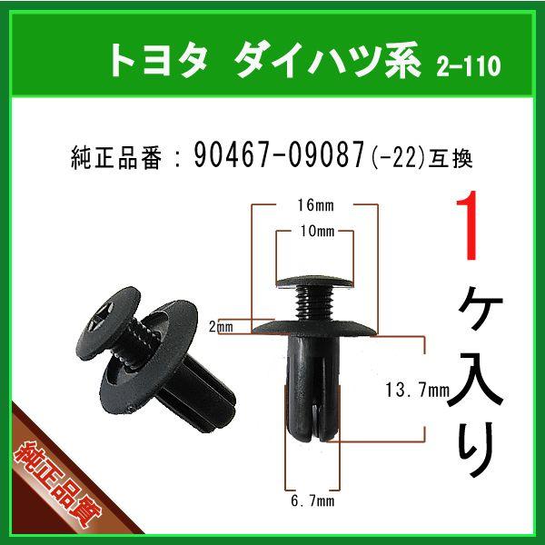

The plastic clips that secure all of the plastics under the hood... anyone know where to find them? Ours seem to be a bit different due to the Phillips head on them. I'm missing a few, a few more are broken... want to get a handful and replace all of them. Anyone got a source where they are readily available before I go to the dealer?

Those are 90467-09087-22. My local dealer only had qty 3 on hand. His computer wanted him to charge me over $2 each, but the guy was nice and said I can't do that, and charged me list, at the time, 97 cents. Parts.com wanted 70 cents each so I bit the bullet and got 30, adding them to the order for the door handle inserts, figuring I'll never need any again.
The ones holding the air intake over the radiator are 90467-08155...

Johnhav I'm not sure that part number is correct. I'm not saying you're wrong necessarily but I looked at the parts diagram a couple months ago and came up with 90467-07146.
That said I bought a 10 pack on eBay for $3.99 plus $2.60 s&h (to Arizona) about a month ago and they work just fine.

Yours look stubbier than original...maybe they fit fine? Mine are the ones the Lexus dealership sold me and they matched them up to what I gave them, which was from the engine area...the websites have dimensions....orig 6.7 mm, yours 6...also shorter...
https://www.buyautosupply.com/produc...nt=45275851727
https://item-shopping.c.yimg.jp/i/l/...-90467-09087-1
