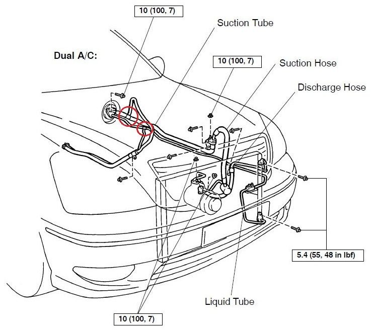

When up on the hoist the mechanic pointed to two pinholes in the a/c line just before the driverside rear wheel.
Could the holes be fixed with expoxy or does the whole line need to be replaced?
Does anybody have a diagram to see where the line starts and ends?

Old Nov 6, 2015 | 04:04 PM

Old Nov 6, 2015 | 05:37 PM
rkw77080's Avatar
rkw77080
Joined: Mar 2011
Posts: 2,188
Likes: 729
The diagram below seems to suggest that the front and rear refrigerant lines are split in the engine bay. I've circled the spot where you may find the splits. Crimping the rear refrigerant lines downstream of the splits will not impact the lines for the front unit.

Otherwise if you still want to go with the "crimping" route, I would suggest doing a clean cut near the splits (see diagram in Post #6 above) and instead of just crimping, maybe add fittings at a convenient and accessible location in case if you change your mind later and decide to re-connect the rear A/C. It doesn't hurt to have a backup plan, right?
I really don't know what effect you will have crimping the rear A/C refrigerant lines, since the compressor is supposedly sized for running both unit. I know in residential A/C if you over-sized the compressor, the A/C will cool the space too quickly and does not stay running long enough to sufficiently lower humidity in the air. I believe (I'm guessing) the LS430 is designed to remove moisture in the air and at the same time maintaining temperature by running both the A/C and the heater concurrently.
