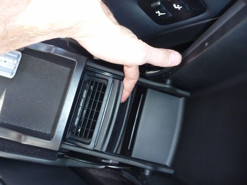

Originally Posted by cyclehead
I took my front armrest apart while installing MP3 player stuff. I thought these pics might help the next guy...
Front Armrest disassy -
Remove a/c vent
Attachment 432546
Remove four bolts and one screw
Attachment 432547
Remove two bolts from the bottom of the armrest storage box
Attachment 432548
Removed armrest assy
Attachment 432549
Originally Posted by dyeem138
I am so glad I found this post.. I was able to remove my armrest, removed all the black tiny screws, separated the leather & the housing..examined the main 2 hinges on the lid, held on to the main housing.. all the 4 golden-colored bolts/screws has fallen out. Does anyone has a picture of how to put back the 4 golden-color screws?
Thank you..
This should help...
