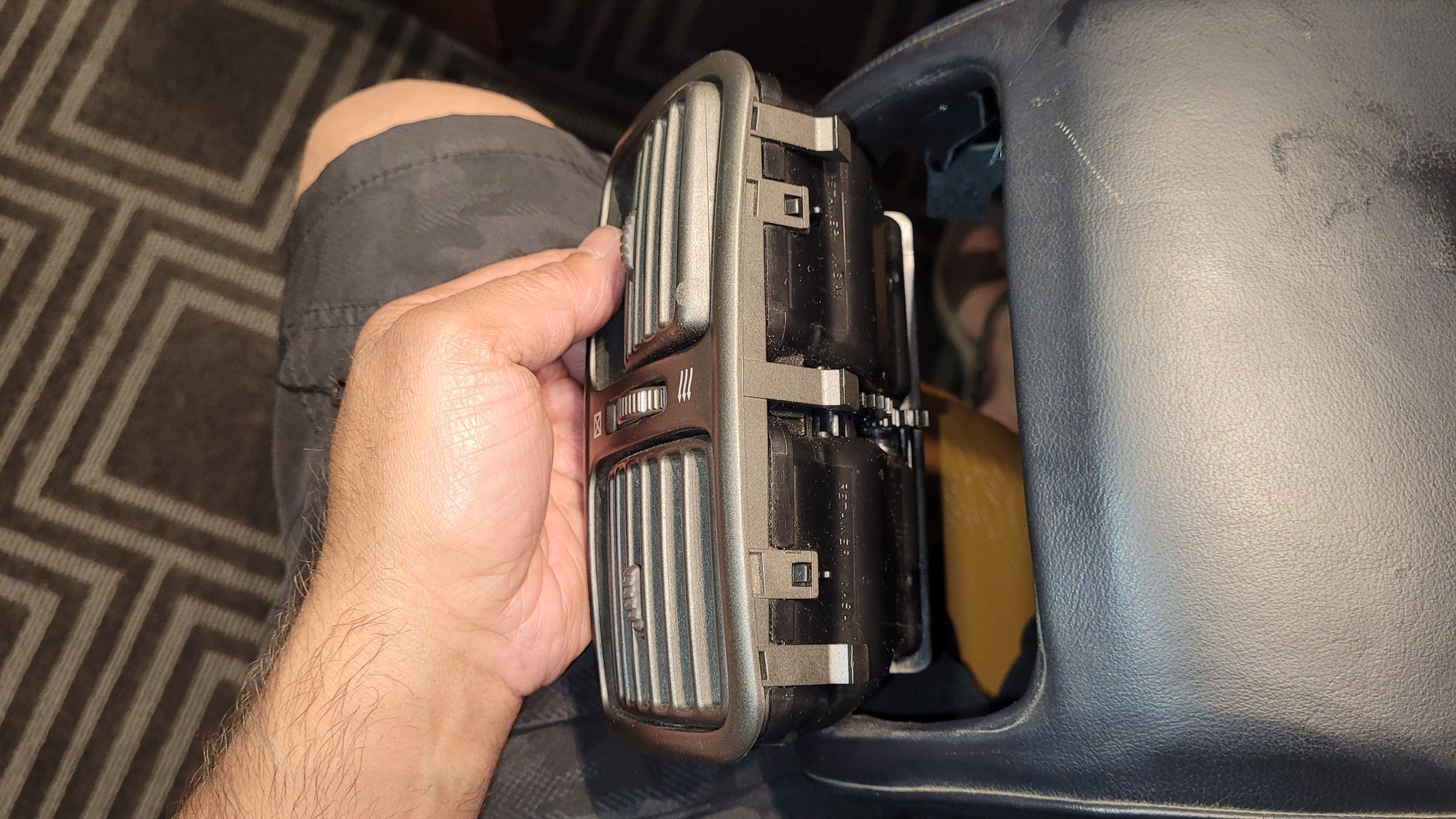

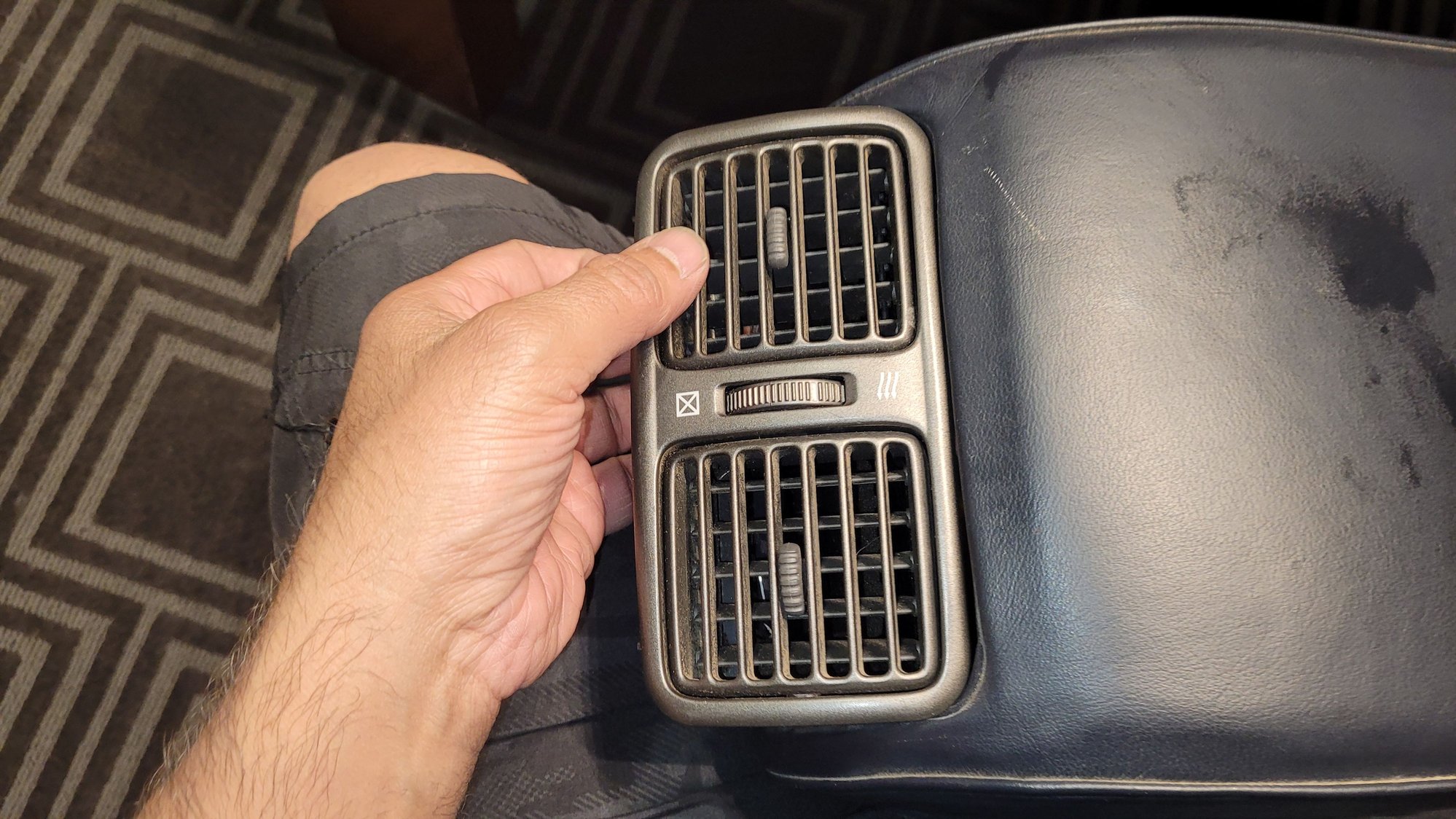

Ill add to this, pictures of the attached rear vent on the armrest and how to remove gently, worked it from the bottom and then angle it out..............

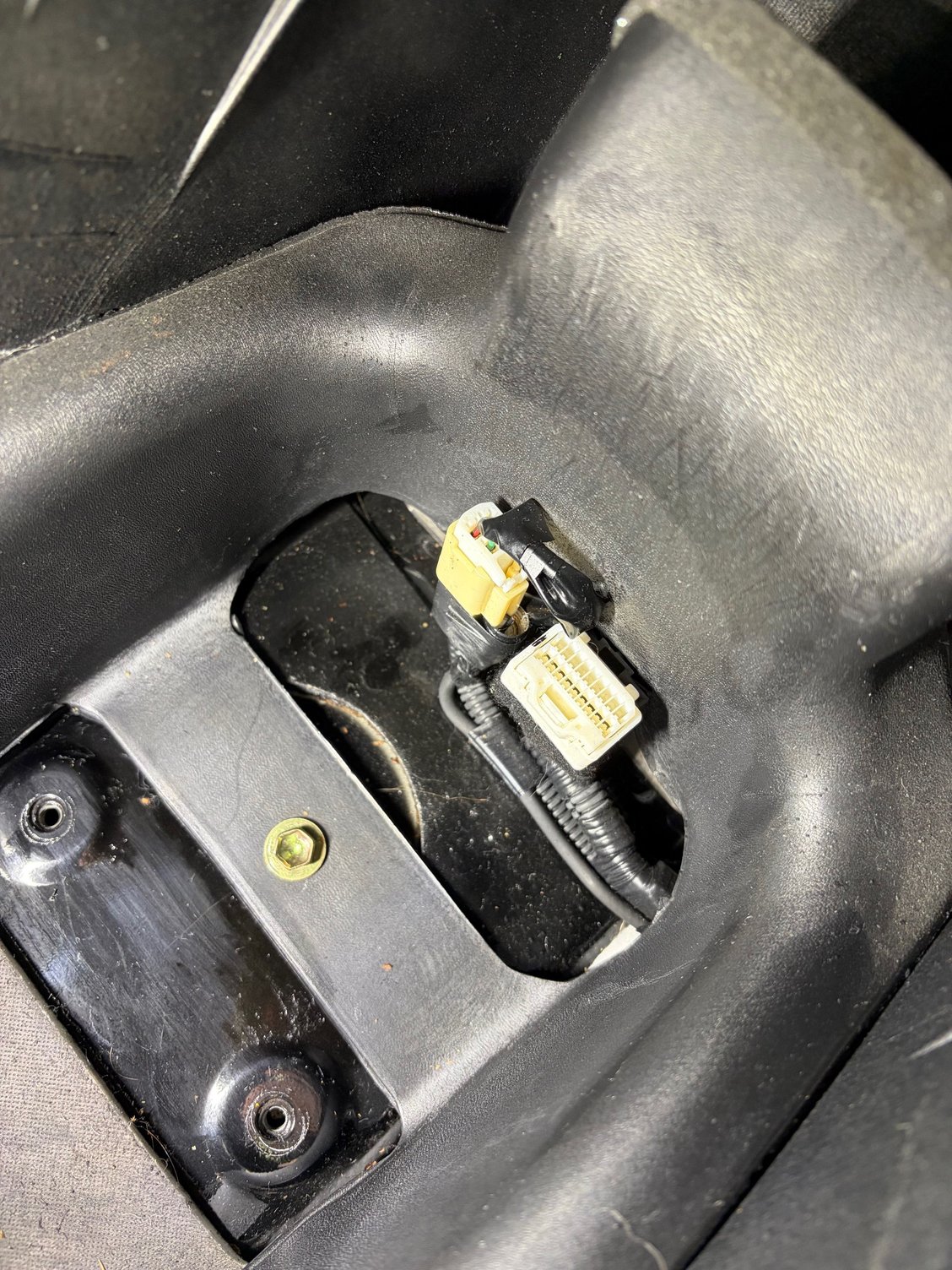

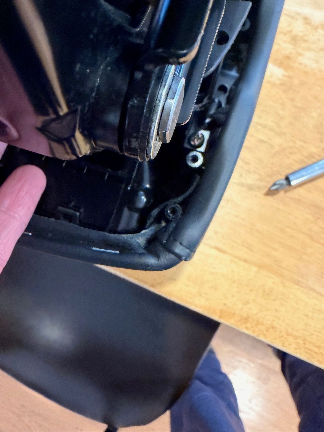

This is the 2nd time I had to do it.
I was having trouble opening the lid for a few week and decided to fix it (again)
One of the screw was loosen.
This time I noticed there are 2 electrical plugs and wonder if anyone know what it is for. If you zoom in on the top one, looks like some antenna cable. The other has nothing on it.
Old Mar 25, 2026 | 06:33 AM
  #130
alextv's Avatar
alextv
Joined: Jan 2004
Posts: 1,934
Likes: 471
From: North Carolina
Those are for cell phone.
