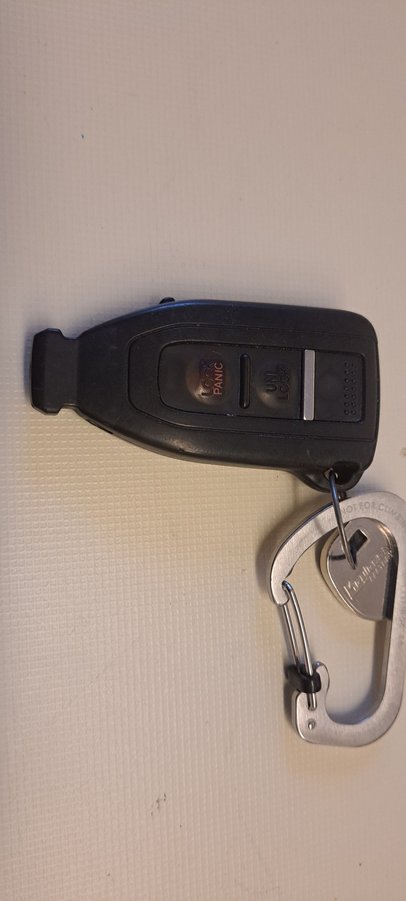

Sure - Its a valet key - 2004 LS430 Smart Key/Fob - Thx

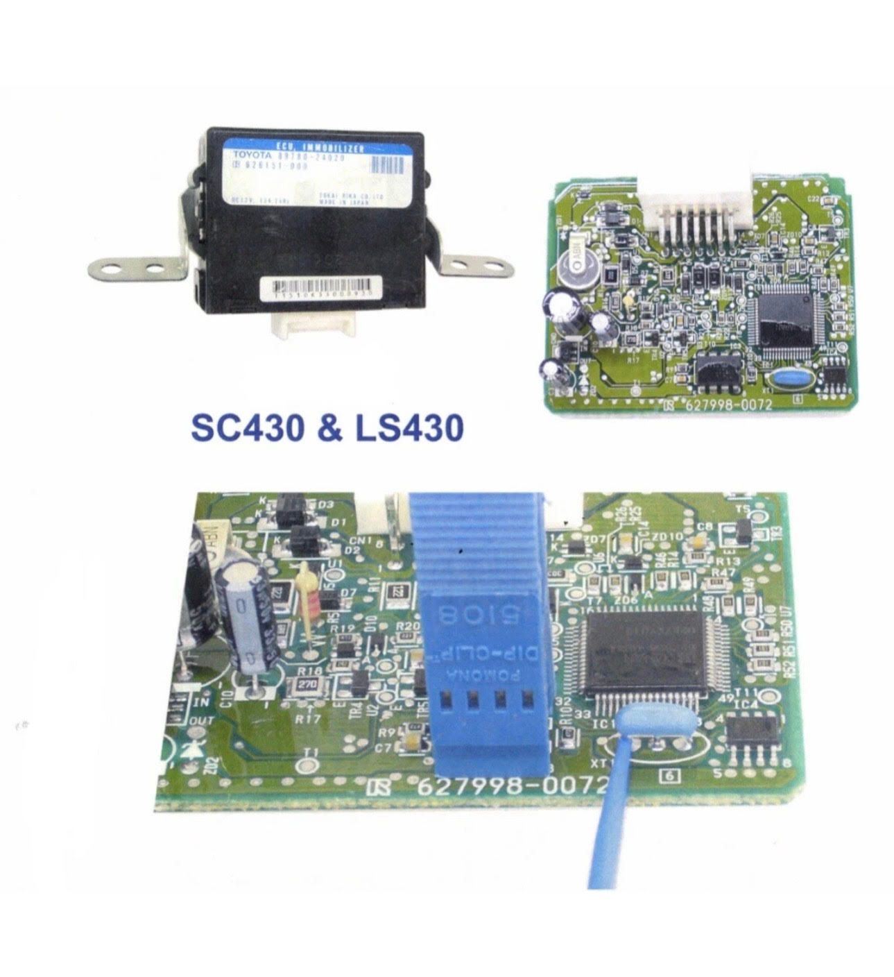

Well, I tried this and the locksmith has this ad up on eBay but unfortunately this is not an ad for a 2004 with smart key - yes the ad says on eBay 2004 but its for the earlier 01/04 model. Evedently there was a mix of old and new in 2004 and the smart key was available on the ML and UL probably. (that is a guess) But anyway he refunded my money and I am getting the ECU back. And that brings up another issue. He shows the ECU and with the smart key you have to flash the security ECU which I think is behind the glove box (guessing on this also) but it was explained to me.
The SC shares some common equipment with the LS regarding the smart key evidently. The locksmith sent me this picture. This is another dead end - and it sounds like the real cost is again what we know and that is the key & flash - And these keys are even more specific. There are part numbers for my car that are not available. The common part number just looking at websites is the 2004-2006 Lexus LS430 OEM Smart Remote Key 89994-50241 HYQ12BZE. I inquired at Key4 (another supplier to OEM keys) and they are saying my actual part number is 89994-50311 based on the VIN. I am wondering if this is another "guess the toyota/lexus variant part number"? Anyway I am going to Lexus to inquire
I am going to speak with Lexus just to see what this retail cost is to program a master key. This is getting pretty deep and I am getting my waders on. The guy Nick has with the $575 is looking more and more the only other way unless it's retail at Lexus
