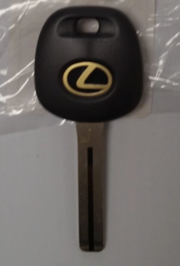

Mine is 2001 but this is what my valet key looks like with no buttons. I am thinking it is more the car fault. My previous post about corroded connector from different thread had exact same keyless problems. What that connector did was short out signal for trunk lock to ecu which affected all the keyless functions.

Can you show a picture of what your key looks like
