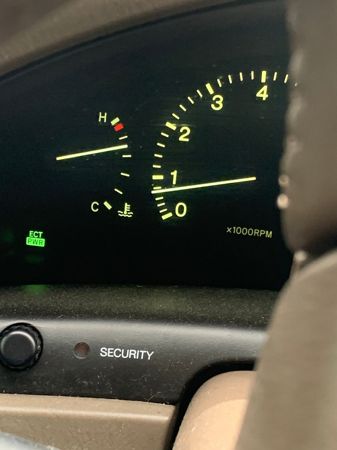

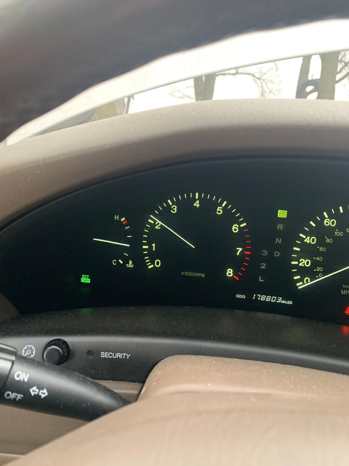

I’ve put it on an incline. Heat on high ran for 20 min 2k-3k rpm and it took awhile but it got up to the bar under the red temp wise. Still no heat and coolant still full. And upper radiator hose did get hot

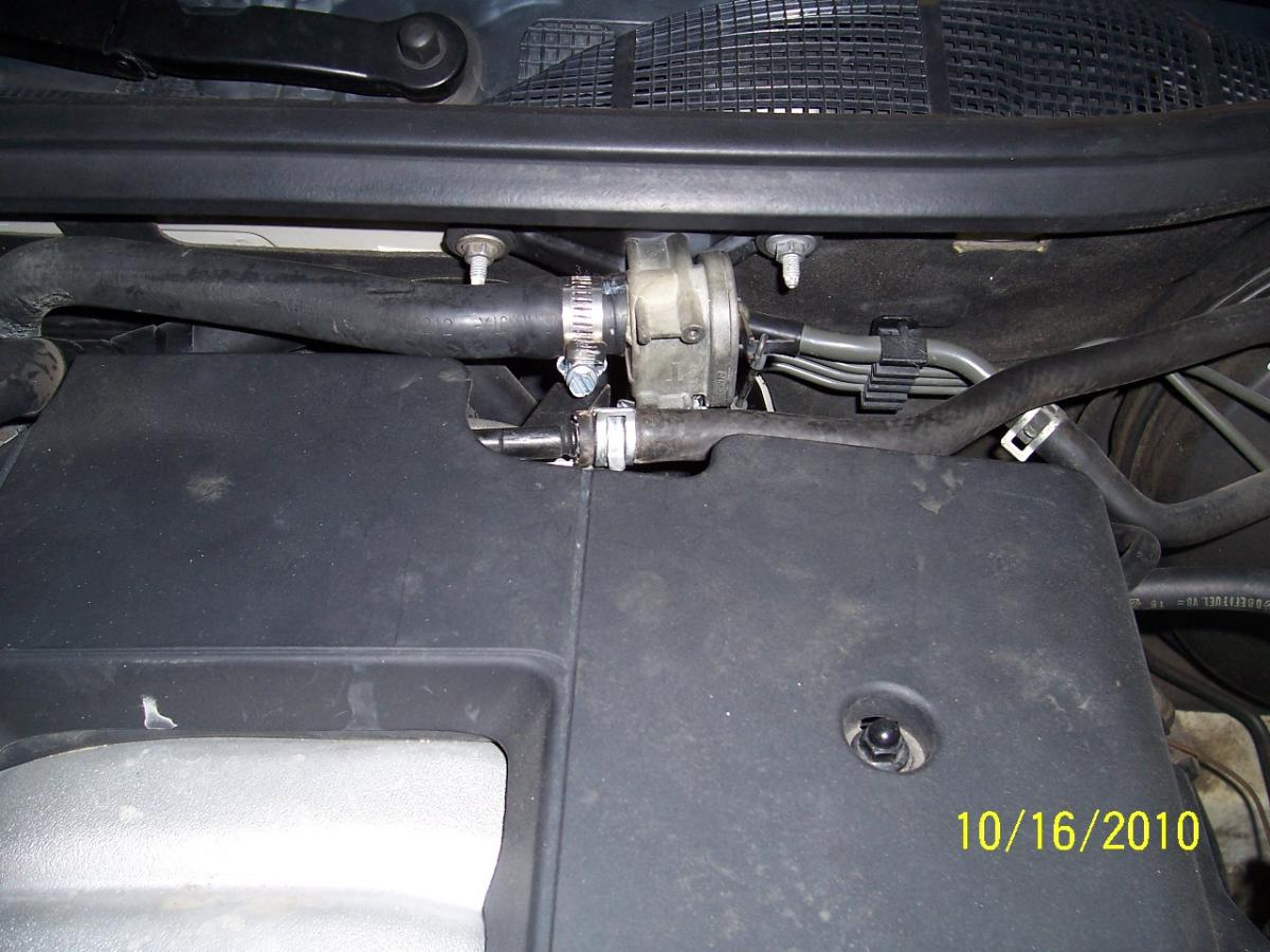

Check the heater control valve...

The lever should move when you adjust the temp from hot to cold.
If you decide to replace it have all the ancillary hoses purchased and ready when you remove the old as they will likely disintegrate upon removal.

Yes the heater control valve works. I guess on with the next suggestions for me to check. Lol

Is the hose indicated by a red arrow hot enough?

Still concerned that the temp is at a higher level than typical operation. How old is the radiator?
The heater core can be flush but be careful.
