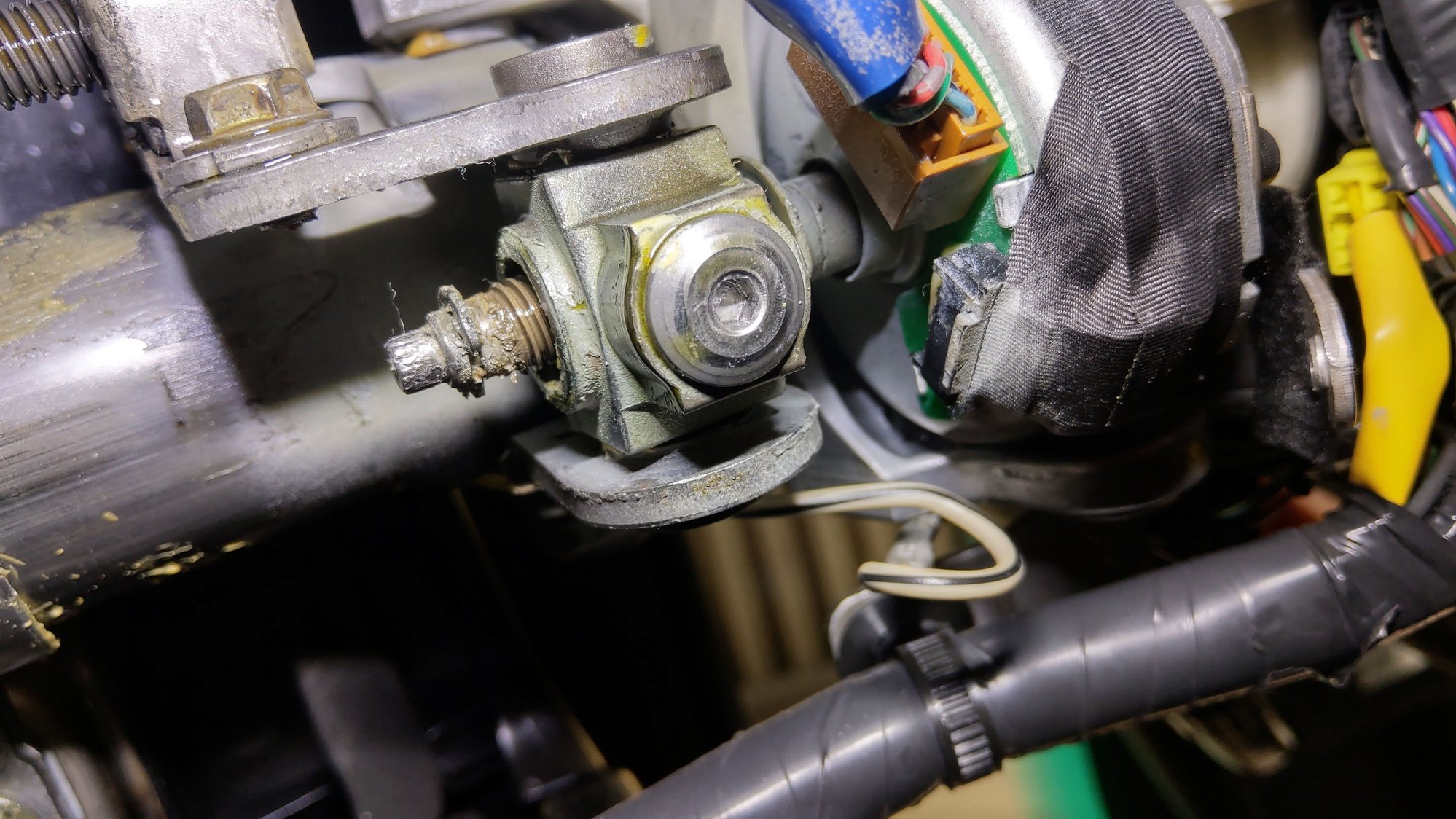

yes I've seen them somewhere in the past. Probable the route that I will be taking. But I've seen a motor listed on one of the TSIB's, so I was also wondering if that is something I should also get.
Like bylan says, on mine it looks/sounds weak. Both of m actually. The tilt function currently looks like its binding making it hard for the motor to move.
Added 2 pictures, this is the tilt motor and screw.
Top pic is lowest position, it sits against that washer or snapring that sits around the screw.
Bottom pic is highest position. You can see that there is still some thread left, but it felt like it hit its upper limit somewhere else.
Hence the question on the total travel that I should be getting

Hard to quantify the distance of travel, I'd guess from the vid it should be 3X what you currently have.
New motors are of course an option but they will be hindered as well until you disassemble/clean/replace the bushing on the threaded rod and re-lubricate. If this basic maintenance isn't done a new motor will likely fail in less than a year...
