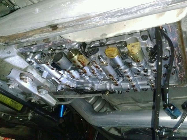

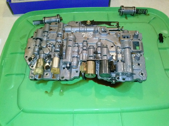

I bought the Trans-go HD2 shift kit last week and finished installing it this morning. All I have to say is, WOW! lol.
When your foot is to the floor is chirps the tires from 1st to 2nd, and launches the car forward. I'm very impressed with this kit, and not too hard to install either.
This was my FIRST time braking open a transmission. It's not too bad once you get the valvebody out and start looking at things. The kit comes with very good directions, and even comes with the proper sized drill bits to modify the valve body itself.
Here's a couple pictures I took. as I was pulling everything apart. I forgot to take pictures after I took the valve body itself apart.

here's another picture of the Valve body. I'll see about taking a video tonight on the way home from work.

I was searching around and looking for options for the auto, because I DID want to go 5spd. But with my budget, I'm going to stick with the auto for now. There is a thread on the SC forum that I had found and I just bought the same kit that he did. He has some youtube videos of his shift kit installed. I think he had somebody install his, but I figured I'd give it a shot. So far so good. The only mishap I had was one bolt braking on the transmission fluid pan. But it seems to be holding up just fine with no leaks.
As far as setting the shifts. It's a matter of drilling holes into part of the valve body. Not as complicated/scary as it my sound. There are three holes that need to be drilled out. The kit has instructions on how to do it, and what sizes to go with. The different sizes will give you harder or smoother shifts depending on what you want. The kit even comes with the drill bits. So, yes you will have to take everything apart again to change the hole sizes on the valve body. But start small if your worried about having to firm of a shift. I went straight to the biggest one.
The only parts needed to do this are:
shift kit
pan gasket/ or factory sealant
tranny fluid
Now, this list is all that I needed. But you might want to replace the filter while your in there. I just cleaned mine up with some brake fluid. The gasket on the valve body can be re-used because it is metal.
