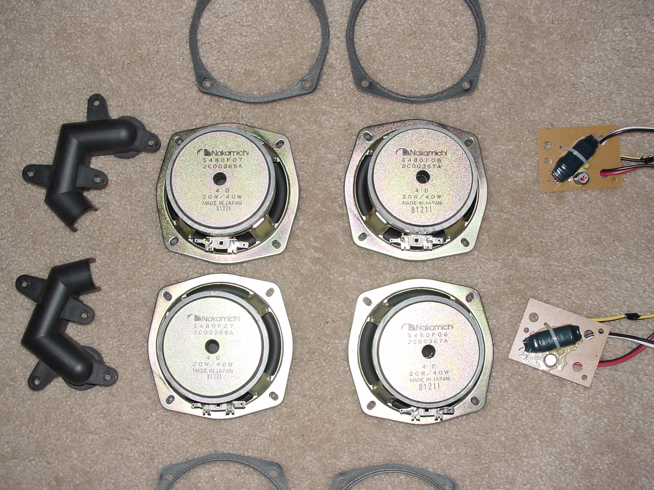

I don't know the impedence of the Pioneer speakers but the Nak speakers are 4ohm (https://www.clublexus.com/gallery/da...5DSC05082.jpeg).
