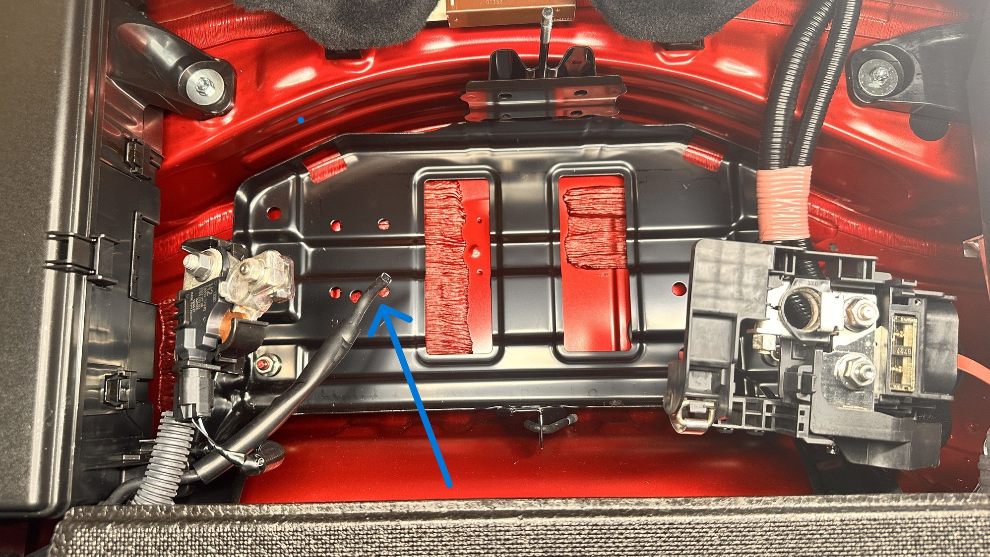

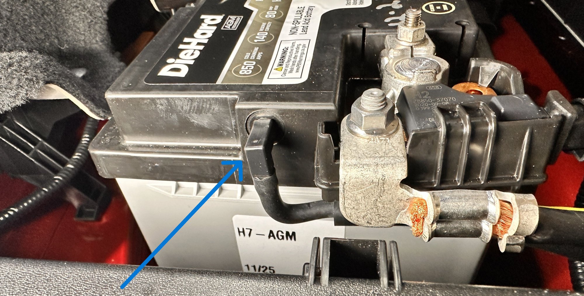

^^ Installed the same Diehard Platinum AGM
I pulled my battery out to swap it and noticed this tube dangling. It took me a while to figure out that it plugs into the side of the battery to vent gases. I'm looking all around the trunk trying to figure out where to plug this thing in
