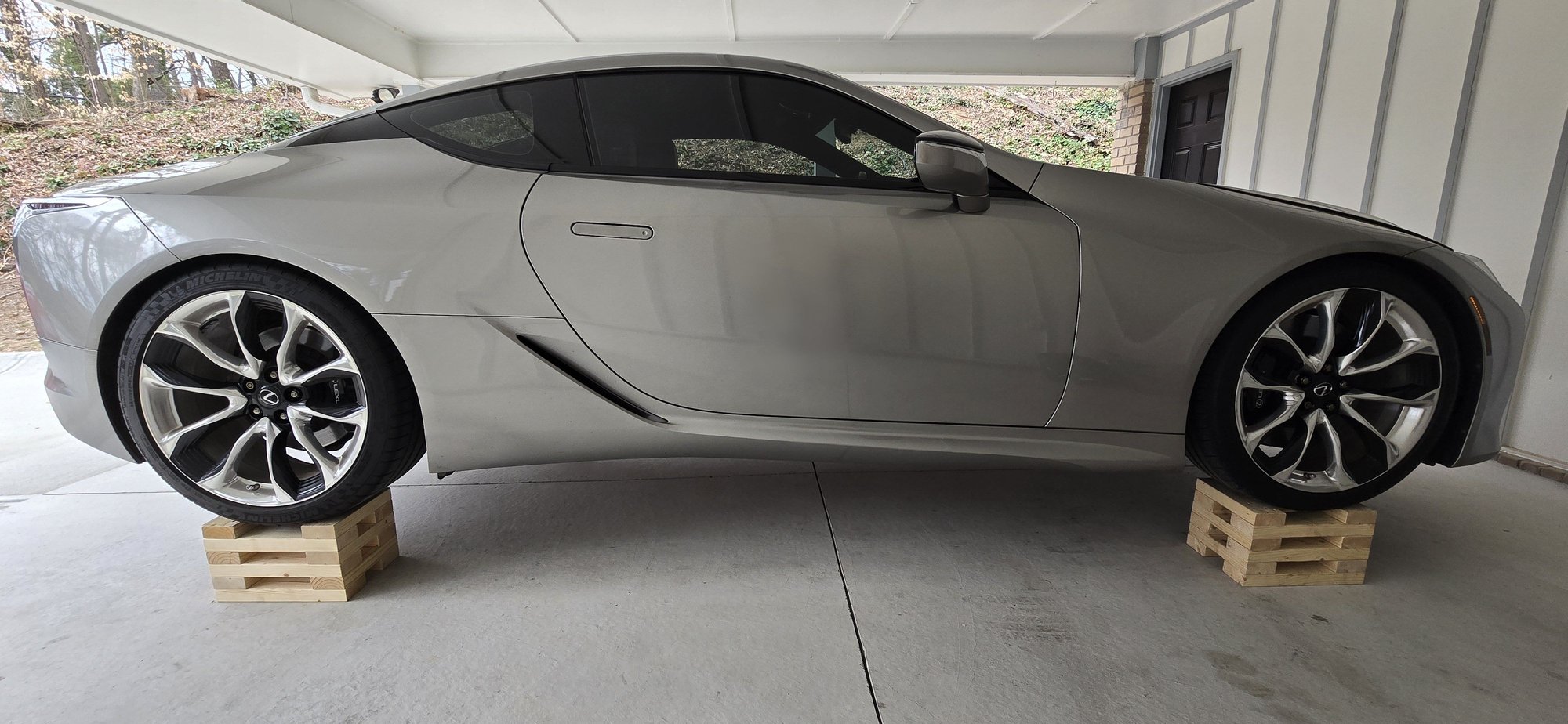

Good day to perform the 30k mile oil change. Actual mileage 29,781k.
This is my preferred method to work under the car...
What is the height of wooden block? Were you comfortably able to go under on a creeper? After reading through all type of jacks and related safety, determined that a setup similar to yours is best to work under the car. I am in the process of making one hence knowing the height will be helpful.
Not sure if I could slide freely under it on a creeper, I'm 6'1" 230lbs. With football player shoulders, lol. I use cardboard to slide around on, when underneath the car. I'm just shy about 1 or 2 inches of being able to turn over, when I'm under the car. a smaller guy would have no problems doing so, especially if his car is stock height...mine is lowered a bit. Here are a few pics of the crib.

If I need the wheels to be free for brake/rotor work, I use the cribs with a couple of 2x4's slipped underneath (2) 4x4's.

Originally Posted by TTBomB
Thanks for posting the pics and dims of the wooden cribs!
On your jacking setup: is the jacking pad on the jack, then the 2x4 on top against the jacking point on the car? Or does it go the opposite way?
You're very welcome, glad to help. I place the 2x4 on the jack pad with the puck in contact with the differential. 👍🏾
